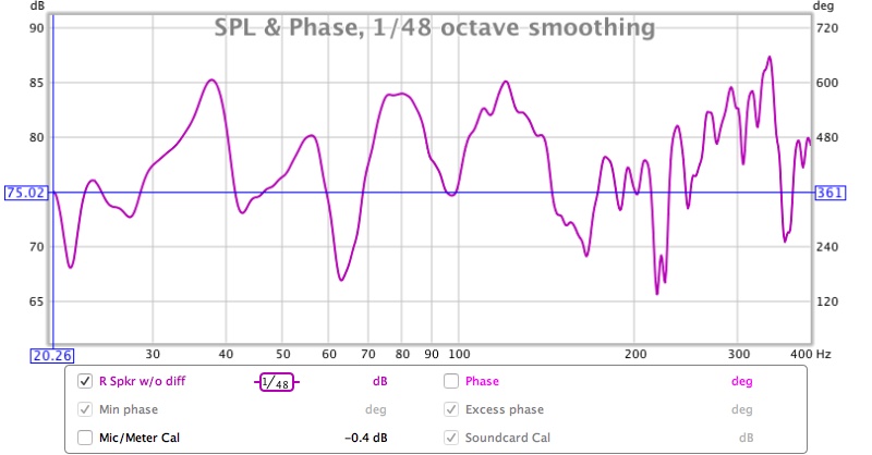

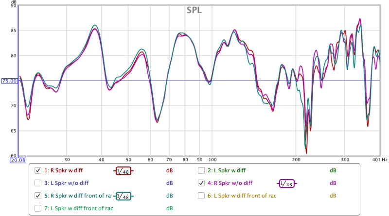

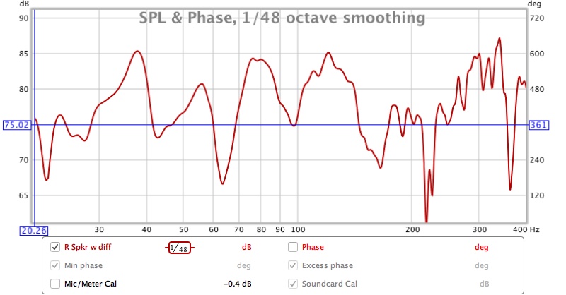

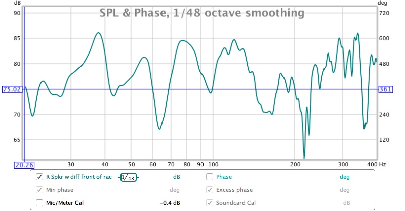

I made a few more measurements today with the diffusers in different locations, I had one unexpected response, it surprised me enough I ran it again, here they are:
Left Speaker without Diffuser
Left Speaker with Diffuser at Window
Left Speaker in Front of Rack
Left Speaker Overlay
The reduction of the 40Hz peak is what surprised me here, I didn't think the diffuser would have any impact on these bass frequencies.  I measured it again to verify, same result.
Right Speaker no Diffuser
Right Speaker with Diffuser at Window
Right Speaker with Diffuser in front of Rack
Right Speaker Overlay
I also tried moving the mic from my current listening seat to several locations in front and behind, it became obvious you would have to tweak the setup for each location as the suckouts and peaks changed with each position change, regardless, I am limited within a couple of feet where my listening seat can be located from a practical aspect.
I also moved the mic to about 3' from each speaker, here I noted a difference at high frequencies with the mic pointed at the speaker vs having it point up.  For the rest of the measurements the speaker was pointing straight up.

Believe it or not, that's not terrible response.  Can you set it to 1/8th and then 1/3rd octave and show those smoothed graphs?  That's generally what you see in magazine and other professional reviews.

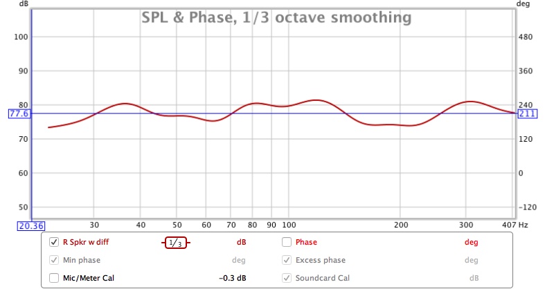

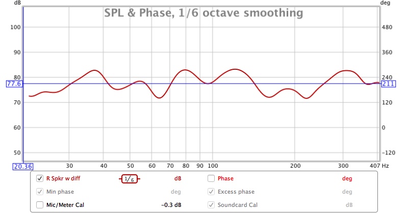

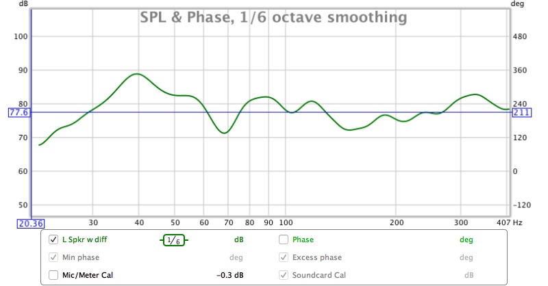

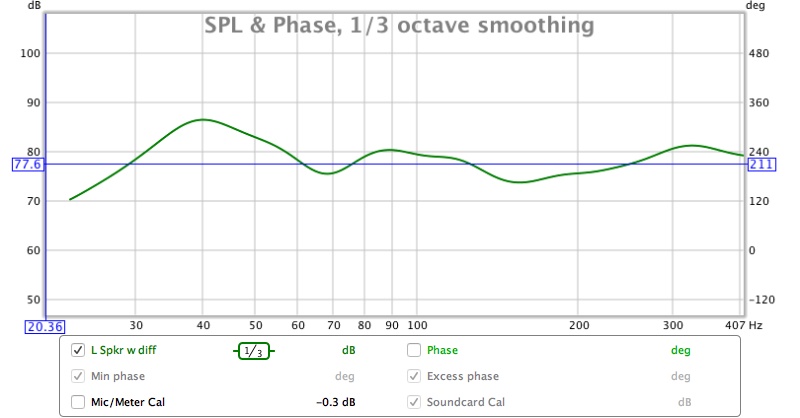

Thanks guys, for troubleshooting the less smoothing the better I would think, but for your viewing pleasure, find the 1/6th and 1/3rd smoothed graphs below:
R Speaker w Diffuser 1/6th Smoothing
L Speaker w Diffuser 1/6th Smoothing
R Speaker w Diffuser 1/3rd Smoothing
L Speaker w Diffuser 1/3rd Smoothing
I tried to recreate the peak reduction I saw earlier in the left speaker, I could not.  Apparently there was some other anomaly with the earlier reading.
This is why digital room correction does not work. After corrections are made, just move the mic a little bit and you have to start all over.
That diffuser might make more of a notable difference above that 400Hz range that you are limiting your measurements to.
