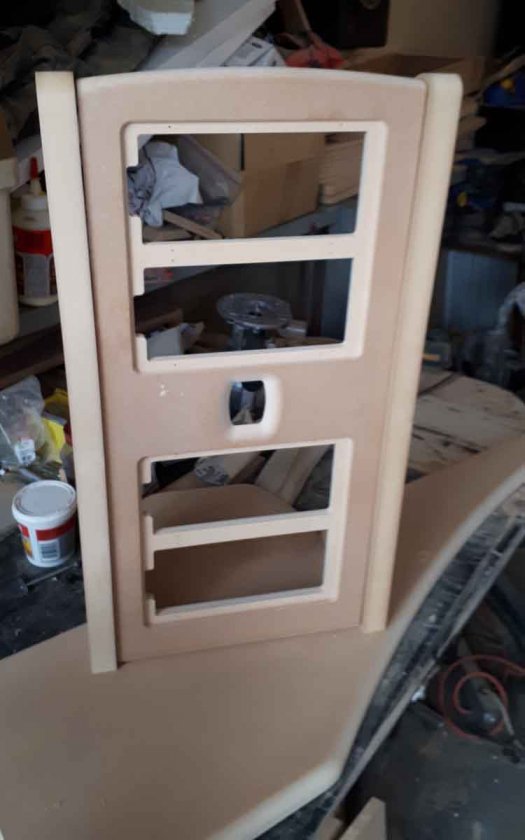

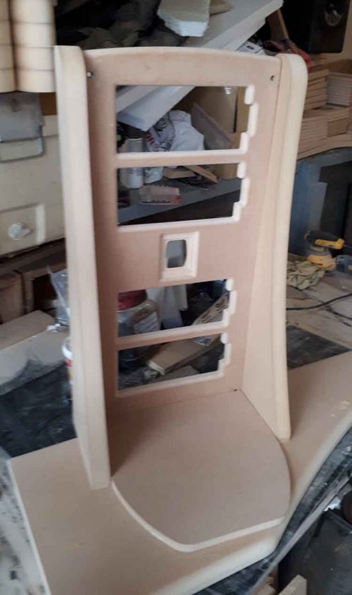

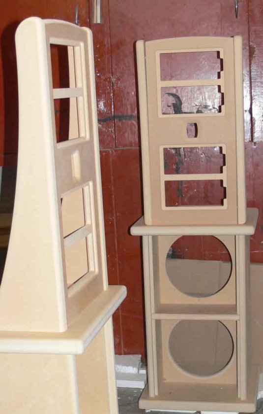

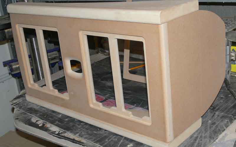

Here is the monitor version  with a  base that is located between the  wings via a couple of dowels in each wing. Left it  simple so folks who don't  want  something  more abstract aren't left out.... if people want tsomething more, they can easily modify  the included bases to  something  that  suits them.
Here a couple   with  the front  grill frame/cloth in place
From front of wing to  rear of  base is just shy of 14"  ( depth of a  dual sub cab with no overhang).
Hang  on for pricing,   I'll  notify when I can
jay

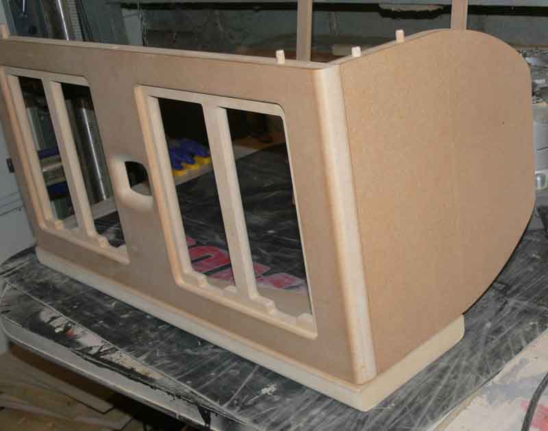

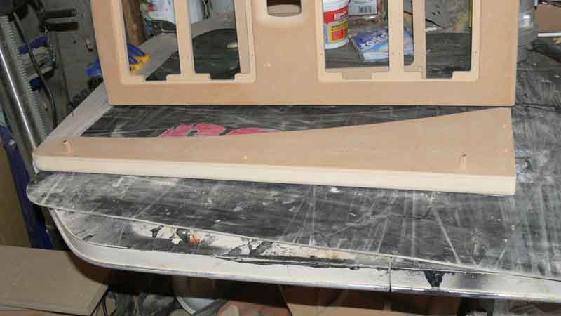

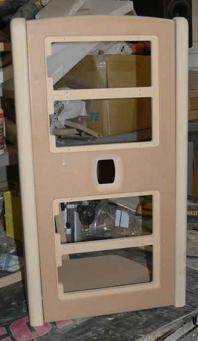

Here's a few pics  with one of  our baffles from the  full Super 7, the  kit's  will all come  with grill frames as well (have them here now but didn't think to include in pics).   Grills and baffles  are  pre-drilled for  3/8x3/8 Nd  cylinder magnets.
Wings will be  rounded over on  outer and inner edge for the  kists.
Super simple for glue up,  3 dowels for baffle,  2 dowels on each side of base.  Baffles will be mirrored for  each  kit  to keep wiring symetritcal.
LOL, I didn't  even have  a pair of  dual hframes on hand to plop this on top of for pics but they will  fit   nicely

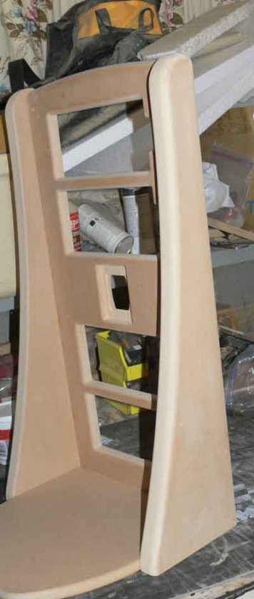

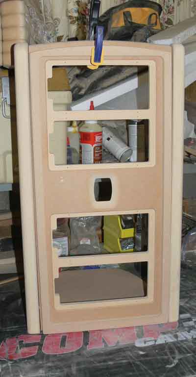

Here's one with the round overs and a  grill frame.
Here's how easy they go together...
Add  dowels to one wing
If this were being  final assembled,  add glue to  the one edge of bafle, one side edge of base, front edge of base and   install on dowels
Add glue and dowels to opposite side of  baffle and base then install  2nd wing:
Stand up and clamp.
With roundovers
jay

Here's a pic   of a couple sitting  on  pair of  our  dula-h-frames
first  few pairs of full super7's are  in the  que
