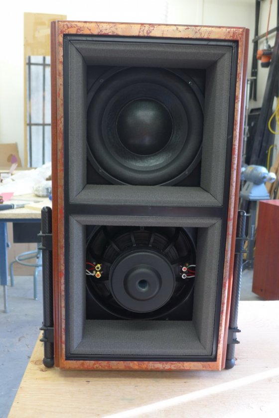

Getting there....

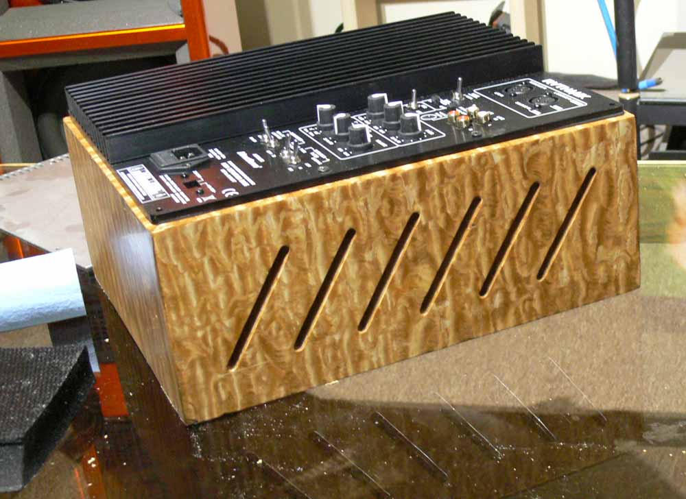

And to go with the  custom Uber  my buddy dave over  at  PI Audio   recently  built  and  surprised me  witha  custom  tamo Ash  case, had to build some amp boxes out of the same

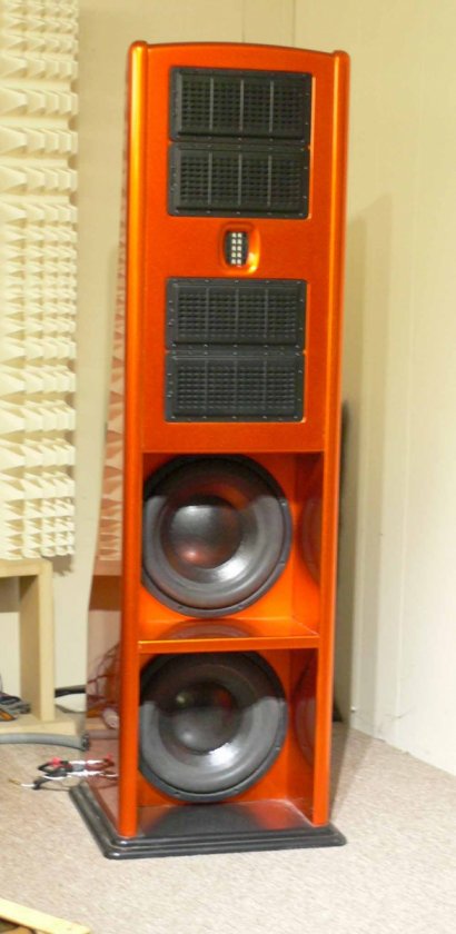

Very cool Jay, I love the colors you have picked for your last two speakers, tangerine and tequila sunrise, terrific!  Those amp cases are gorgeous as well.  Looking forward to your thoughts regarding the sound.

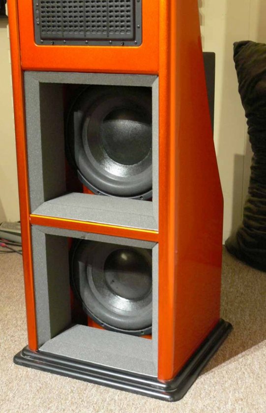

Can you get by without using no-rez on the fronts? Hate to see any of that paint covered.

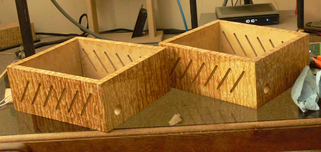

Thanks Ed.   Yes, the colors  are similar but  different... these  are  a bit more intense, especaill when the  sun hits them or  even how the room lights reflect on the  edges  I'd say. Amp boxes are  coming along,  a couple more sessions with the danish  oil  and  they should be good.  All filled up with  oil  /  Tamo Ash slurry.   I may not even top coat them... we'l see.
nrenter, ,   I know how much those  woofers load the  h-frames  so I'll be using the no-rez. Kind of a shame to cover  it up but  there will still be  lots of color visible :)
I would love to hear any input on this as well. I definitely want the benefits that the No-Rez provides, but there has got to be a way to make the exposed No-Rez look a bit better (doesn't there?). Even something over the front facing edges would help.

I remember when Tyson   stated that adding the no - rez to his super7's makde  a signifigant improvement and cleaned up the bottom end somewhat.
You  can  miter cut the  no-rez to give a different look
I'll end up  having the  full length grills in place  half the time  ... I usually remove them for any serious listening but for day to tday ,  I've often had them in place with other  speakers
The front and corner bevels look great.  I saw someone else do a 1/2 flat - 1/2 bevel on the fronts that also looked great.

Enough with the foreplay Jay! Time to hear the comparisons of these beauties versus your older NX-Oticas. Give it to us straight bro!
Ron,   they aren't quite done yet .  still need to wire up the  2nd  speaker (this wekend) and am finishing the  sub amp boxes so that I can get the  A370's mounted
Yes,  folks have  cut the no-rez in different ways to  produce different looks, lots of ideas out there.  I left  these pieces a bit longer thanb normal to get as much  of the   hard damping layer contacting the panels as possible.... i bevel cut the rear edge  just  like the front to provide ample  woofer  clearence .

Eneded up doing a  few more sessions of  grain filling then finished  everything off with 3  satin top coats
Will post  a  fw pics of everything  finished up  in a  day or so

I like the look of this partial miter cut as mentioned previously.  Found the pict and thread.
https://www.audiocircle.com/index.php?topic=139529.msg1558158#msg1558158

Those amp boxes look fantastic.

« Reply #238 on: 8 May 2019, 11:56 pm »
The NoRez in this picture is both mitered and beveled. I've done it this way for a client and to me it looks neater than square cut but it used about 1/3 more NoRez than straight cut so order extra NoRez.
