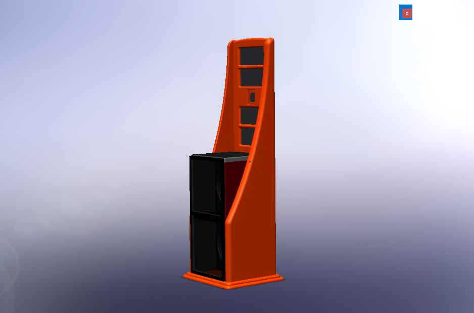

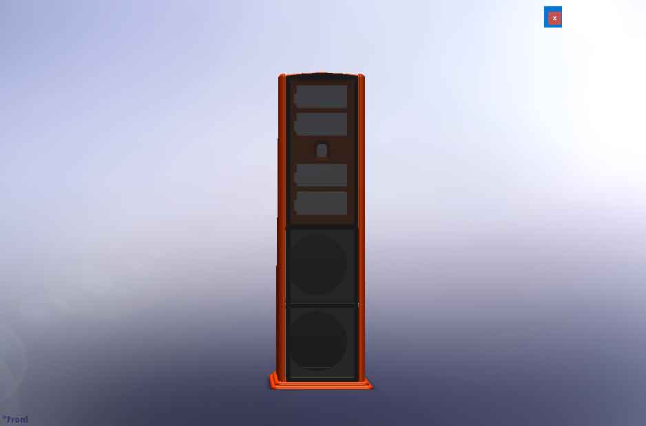

The  speaker is coming in at 56 tall with the tweeter / waveguide center at  42.25"....  these measurements include the  1.25"  base.
I can't really determine final pricing at this point, still too many variables (more programming, custom boxes/packing, yeilds per  sheet  etc  etc
greg,  the baffle is  13"  wide, the overall wideth  (no base) is 15.5" which I believe is  very similar to the  original design.
Tweeter  height of the  tops section only is 14" (again, no base)

Jay,
I thought I remembered reading earlier in one of these threads that this design lowers the height compared to the original S7 a few inches?  If so, I remember the original S7 had the crossover mounted on top of the woofer box, so do you intend to have a similar crossover enclosure on this kit or did you find somewhere else to hide the crossover?  If the height was lowered enough (in particular if someone goes all in on some really big caps and coils in their crossover), I might be concerned that the lowermost Neo10 would get blocked off more than desirable with the crossover box?
Re: Super 7 Flat Packs.....
« Reply #37 on: 13 Aug 2018, 02:31 am »
Hey Jonathon,
Yes,  big , botique caps  could be  an  "issue".  If going that  route,  I'd recommend going with   external  c/o's.
Have already been giving  this some thought ..... a  double  layer  amp box that  could   server  double duty as a  c/o  encolosure  as  well might work well...... :scratch:
jay

I think the sketch-ups look awesome. They have lines that don’t look DIY. This is a speaker you could LOOK At for a long time.
The only shame is that, unless you have professional finishing skills, your world-class sounding speaker may still look DIY. I’ve seen Danny’s personal S7’s and they are sexy. That paint was amazing, and probably not cheap. Is it possible to bring that level of fit and finish to Flatpacks? Could solid surface material be CNC’ed, shipped, and assembled not unlike IKEA furniture? Just throwing it out there.
