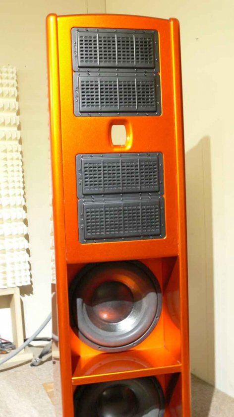

House  of Kolor  "tangerine
Jay,
That color is growing on me more and more... as a vehicle color too. I was going to go with British Racing Green. But there is a deep rich candy red I like.
Post a picture when they are together.  BTW how do you glue/clamp them without damaging the paint?
Steve
Re: Super 7 Flat Packs.....
« Reply #189 on: 29 Mar 2019, 02:37 am »
I run mine in a dedicated space in the basement, 19 x 13 and they are awesome.
Hey Steve
When we went to pick up the parts from our painter, he  was all  over the same thing... he is dying to paint  a  car in this color  now.
It's  growing on me  me   too, the more  I see it, the more  I  like it .... and in the sun it's   insane.
We're Likely going to use a  high quality clear  silicone to glue the painted  surfaces with wood glue onthe  wooden dowels  into bare wood dowel holes. I know  someone who did the same   with pre-painted cabs andit worked very well.  clamping will  be an excercise in using caution.... only enough presure to seat   things and  no more.  Will likely cut up some micro-weave fiber to wrap around the clamps as well.

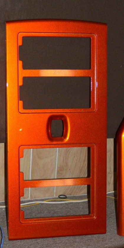

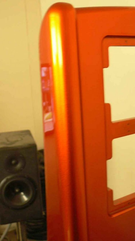

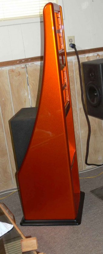

Here's a  couple  updated pics of the pair we're building out here. Waiting on Neotech UPOCC wire then will build out networks and wire everything  up.Will  post more   when  we are  done...
First  2 full  flat packs are boxed  and ready to ship  this coming week
jay

Here is the monitor version  with a  base that is located between the  wings via a couple of dowels in each wing. Left it  simple so folks who don't  want  something  more abstract aren't left out.... if people want tsomething more, they can easily modify  the included bases to  something  that  suits them.
Here a couple   with  the front  grill frame/cloth in place
From front of wing to  rear of  base is just shy of 14"  ( depth of a  dual sub cab with no overhang).
Hang  on for pricing,   I'll  notify when I can
jay
