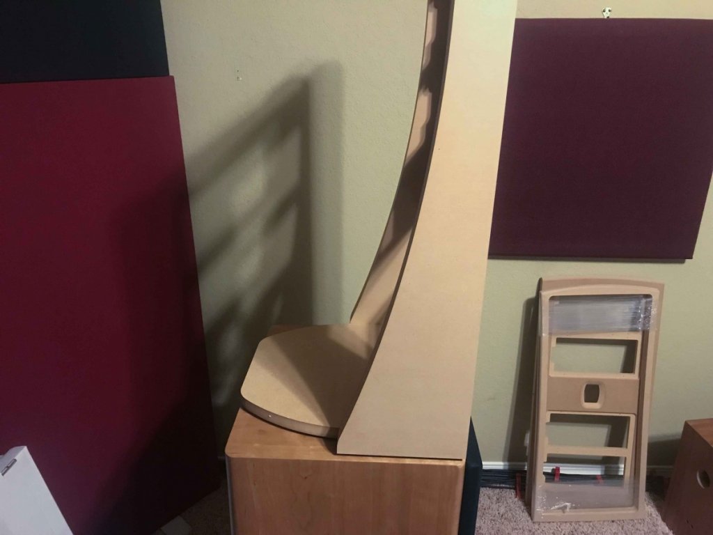

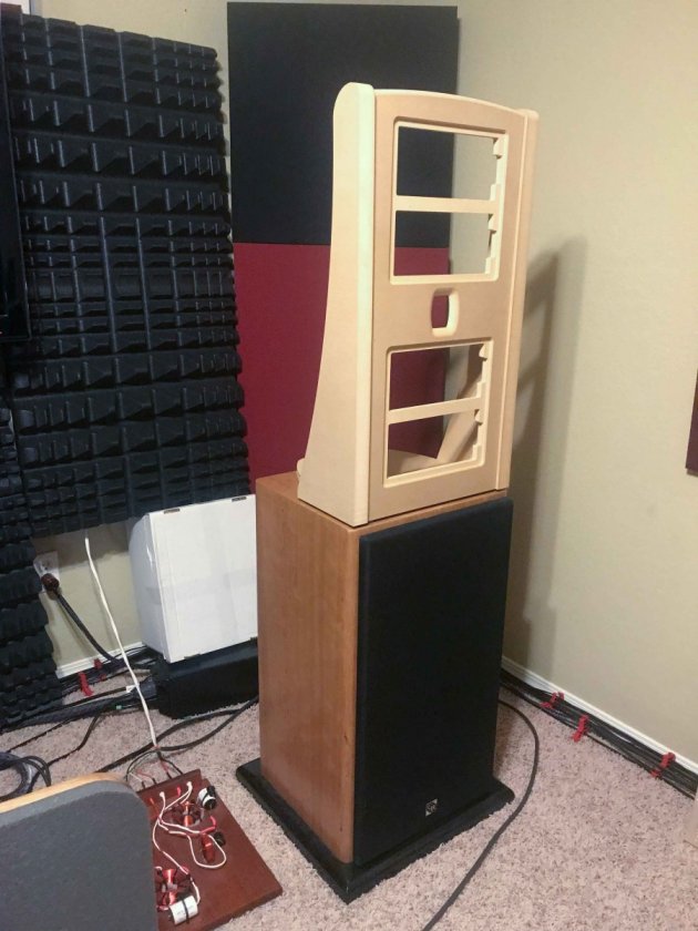

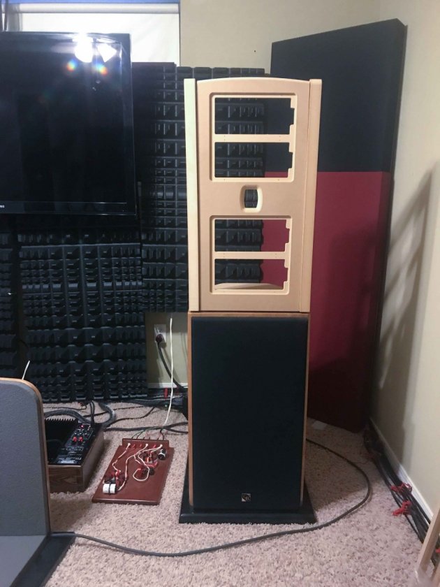

Got mine last night. These are just dry fit together to see what they looked like on the dual H-frames.

Ed,
My plan is to cut the sides and base out of figured cherry to match the subs. I will use the sides and base from the kit as templates. Because of this, I asked Jay to not round the sides over. The pieces will work better as patterns with straight edges.

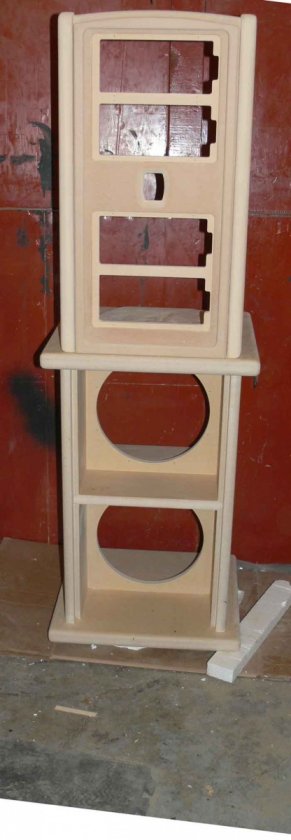

A Super 7 monitor and   dual h-frame fully prepped and ready to  go to paint.
This set is going to be used  as a  center  channel with a pair of  Line forces.
jay

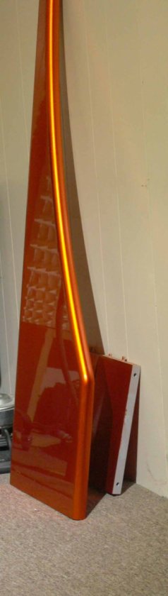

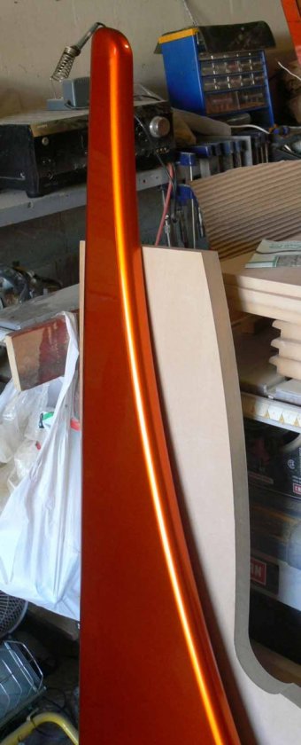

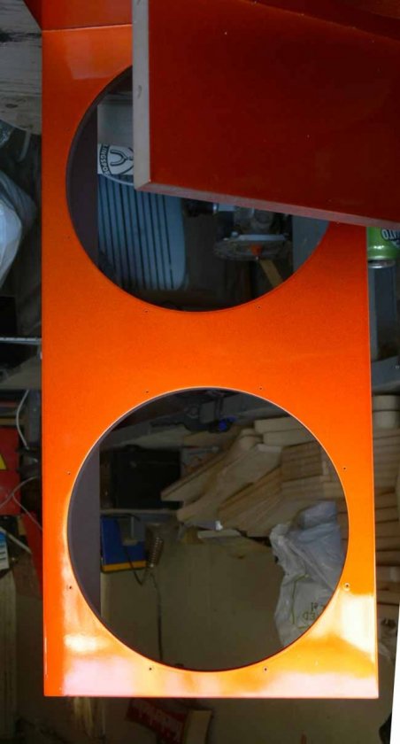

A few updated pics of the  Super 7's build state...
Went with   House  of Kolor  "tangerine  for the  side panels,  the front baffles,  the  frontof the  sub enclosures and the  front  braces
https://www.houseofkolor.com/kolors/detail/index.html?id=S2-KBC08&ref=kolors
A couple pics
This is  a deep  kandy  color, it is pretty cool. It can be pretty  dark  in  dim light but man, when any light hits the edges, it  POPs.
Still need to   get the bases  done in  satin black  and spray out the inside of the   rear sub enclosures (satin black as well).
Getting there

Thanks Jeff. The sun is poking through  the window this am and  man, it's crazy   what the HOK paint does in the sunlight.
In many cases, we paint after  asembly but  with these and the  Kandy color,  we had to go this route to keep the  color  consistant.
With the lower  rear  subs section of the  S7's being  a  separate sub assembly,  it makes it pretty easy to do,  hopefully  I still say that  after final glue up !
