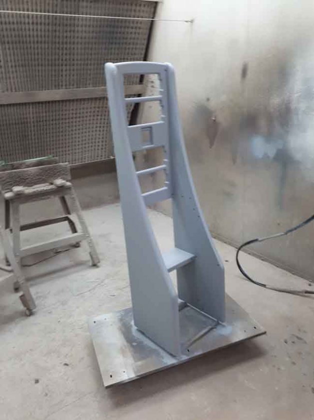

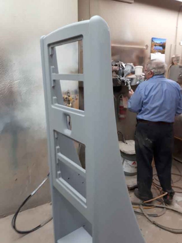

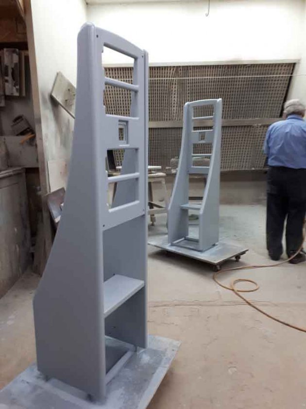

Re: Super 7 Flat Packs.....
« Reply #130 on: 10 Feb 2019, 05:14 pm »
We finally   spent an afternoon  on the Super 7's.  Primed and ready for  another  round of block sanding
Getting  closer to some  color
You  guys should start  getting  your S7 monitor kits this coming week.
jay
