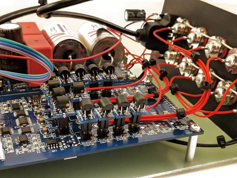

First production pics of the LDR300.V25. Internals with rear panel but without the front panel.

I'm pleased to announce that we've made some changes for the better to the LDR300. These changes were initially prompted by feedback we received from the LD300 tour unit but as we looked into the original design we decided to also make several additional changes. The net net of all this is an even better sounding preamp.
Here's the summary of the design changes:
1) Deleted the input coupling capacitor - it's now direct DC coupled
2) Added 2-stage internal split voltage power supply with SMPS 1st stage and linear 2nd stage (was previously a 10 V single linear supply)
3) Changed from 12 V to 24 V - 500 ma external power supply input
4) Additional power supply bypass capacitors - Elna Silmac II plus Vishay Polypropylene
We actually went through several iterations before settling on this approach. The output DC offset is almost zero but we kept the output coupling caps to avoid the complications of DC offset protection. The sound is more natural and relaxed and not quite as solid state dry as before. Overall a more pleasing listening experience.
By going with split voltage the PSRR is now huge (meaning VERY quiet) since any noise on the +/- voltage supply will be next to invisible at the near zero volt DC buffer output signal half way between the power rails.
We're waiting for updated production circuit boards at this point.
Once we have production boards we'll  be sending out the tour unit for its last few stops and anyone else who may be interested in giving the LDR300 a try - just let me know.
Morten  :thumb:

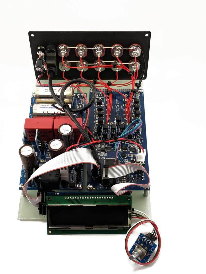

The LDR300.V25 Buffered Preamp has now been updated with a substantially redesigned SSB.V2 (RevA) solid state buffer board. The result is a combined LDR attenuator plus minimalist JFET split voltage buffer that is a delight to listen to and takes the LDR300 to a new level. I'm very very pleased with the results and do not anticipate any change to the LDR300.V25 going forward after this design update. At least not for a very long time.
All back-ordered and new LDR300.V25 orders will be built with the new SSB.V2 buffer design.
More info on the LDR300.V25 can be found here:  https://www.tortugaaudio.com/products/buffered-preamps/ldr300-v25-buffered-preamp/
The rough bench pic below shows the new SSB.V2 buffer board in the foreground and the LDR.V25 preamp controller board in the background. The buffer board is roughly 45% power supply & controls, 45% output coupling caps and 10% actual buffer signal components.
