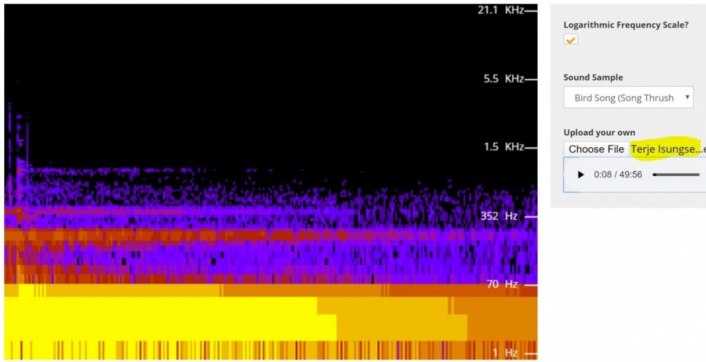

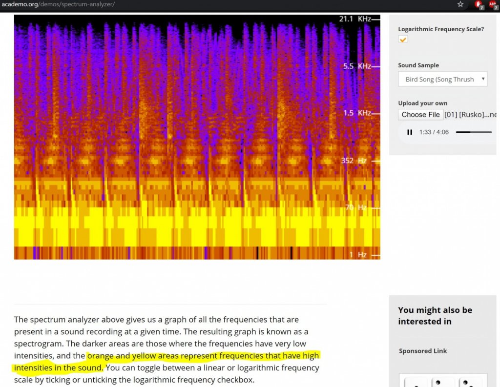

Hello Jay,
Thanks for your track I didn't know ''terje Insungset'' I love it it sounds like Bjork stuck in a truck in a middle of a storm in Quebec with Hang massive freezed in the trunk.
So I did find a tool to analyse the files I found that Rusko's track do have low frequencies as well, but the sound is way faster.
see below
Rusko Bassline
''Terje Insugset'' (never ask me to prononce this name) Bassline
I also listen to way down deep, with my headphone, (that goes to 5hz) this is not even the same song than on my speakers... !
In conclusion I will probably select an artist I know that has similar bass than rusko in a much slower pace such as Amon Tobin,  ( https://www.youtube.com/watch?v=BiPu-qYBTZU )  I think that should be a good test. And have another track to assess speed, and not both at the same time.
But in a nutshell that answers my question... I will need at least 1 sub. and a super fast one.
Thanks for providing a clear explanation, that helped a lot.

Hello Jay,
see below
