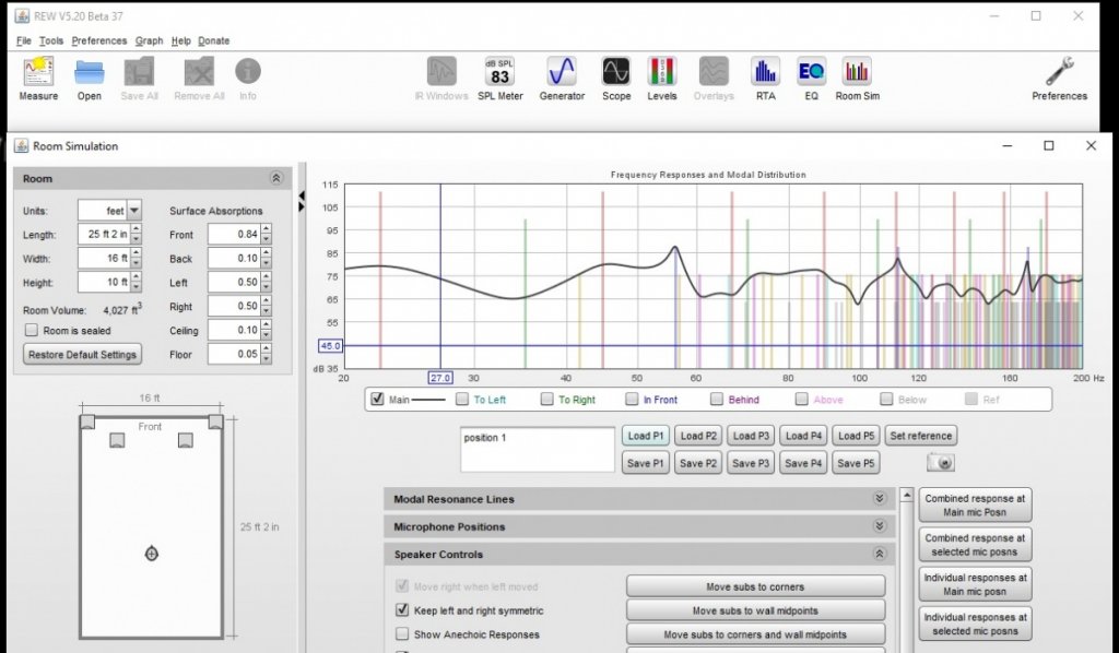

The latest REW has updated room modeling with ported and sealed subs for 200Hz and below.  A simple start to see speaker positions in a user defined rectangular room model.  Looks to be a room modal model and the speakers are movable and surface reflection coefficients are inputs.
Just click the Room Sim button.
HAL,
That room simulation model in REW has been out for over a year now, but the problem it has is that it assumes a room with very low leakage and also assumes one has a room that is a simple shape, ie rectangles or a variation on rectangles, the worst being a square from a modal standpoint. It's very cool indeed and I did play with it even to see how well it could predict things in my room which is very much rectangular and quite sealed as well. John Mulcahy has also been very open to improvements to the model. For a free program, it's pretty nice and the accuracy is not too bad even in custom rooms like my own. My colleague who has a rectangularish room but with 20 foot ceilings didn't find it to be as useful as just using the mic and making real world measurements.
I've talked to Nyal Mellor of Acoustic Frontiers quite extensively about boundary element software solutions and he does provide a service with his own software but it can get expensive. That being said, I can see it as a feasible solution for folks who do not want the diy approach:
http://www.acousticfrontiers.com/services/design/low-frequency-optimization/

Anand,
Yes, he posted that last week he had updated the room modeling in the latest beta release.  After that you can do measurements and see what you have.  Very useful and on my systems for use.
Other programs like CARA 2.2+ have more involved modeling capabilities for complex rooms.  Been around a long time and uses ray tracing models.  Good video that gets you going as it is complex.
