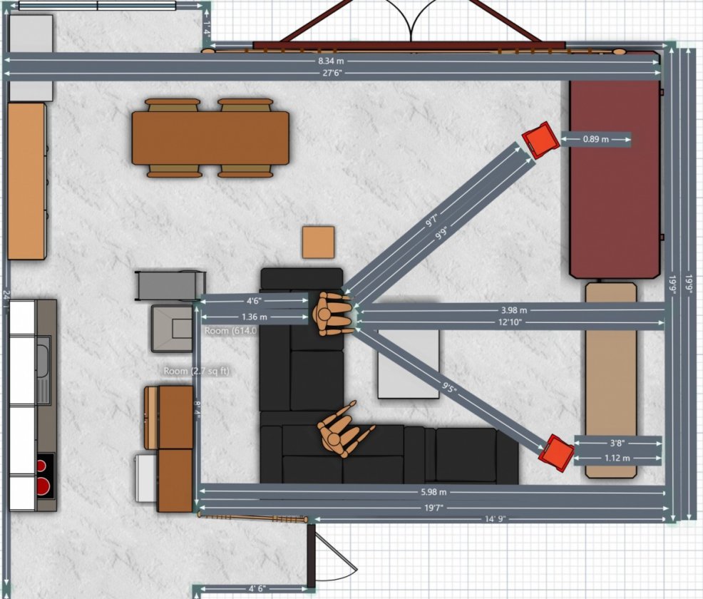

So GReat news I solved my Acoustic issues in about a week with the Audiocircle folks, Thanks to them !.
Now I have this new setup, and it works well, the question is Will I need a sub in this room knowing that I already got great bass with B&W 686 bookshelves and Digital APO EQ Loudness activated ?
The room dimensions are below:
Original thread on Acoustic problem https://www.audiocircle.com/index.php?topic=167755.20

« Reply #23 on: 4 Feb 2020, 04:41 pm »
So GReat news I solved my Acoustic issues in about a week with the Audiocircle folk, Thanks to them !.
If you want full range sound (down to 20Hz) then yes, you need a sub. However, if you are happy with the bass output you have then no, you don't need a sub. It comes down to personal preference.

Zitoun
Re: NX-Otica / No Subs - With some low end ds0p
« Reply #30 on: 5 Feb 2020, 03:41 am »
Mike
Thanks Mike, I guess my question is more around the ratio room size / lowest frequency response audible. Is there a way to calculate how low the oticas on their own will go in a specific room size ?, and will this be consistent over all type of music? Or it's more about luck, trial and error ?

Your new room layout should give you better bass from the NX-Oticas without subs, particularly with a bit of bass boost equalization. If your happy with the bass from your bookshelf speakers, you'll probably be more than happy with the NX-Oticas.
The NX-Oticas have exceptional mid-to-upper bass so things like bass guitar, drums, and deep male vocals have excellent energy and impact. Probably the best I've heard in this area.
That said, with music that goes deep, the stereo OB subs are to die for. The clarity, speed, and naturalness of the bass is fabulous. But there is a lot of great music out there that doesn't go so low that you'd really miss not having them. So it all depends on the type of music you like and how important really deep bass is to your enjoyment of the music.
You can always start with the NX-Oticas and add the subs later. Or start with one sub and add the second down the line.

I don't think there is any way to predict the exact bass extension you'll get based on room dimensions since it will depend a lot on speaker position, materials used for floor, walls and ceiling, what kind of furniture you have in there room, etc. But since your new layout reduces the distance between the speakers and sidewalls (particular near the left speaker), this will definitely reduce the rolloff.
The bass extension you get will not be dependent on the type of music, but how noticable the rolloff is certainly will.
