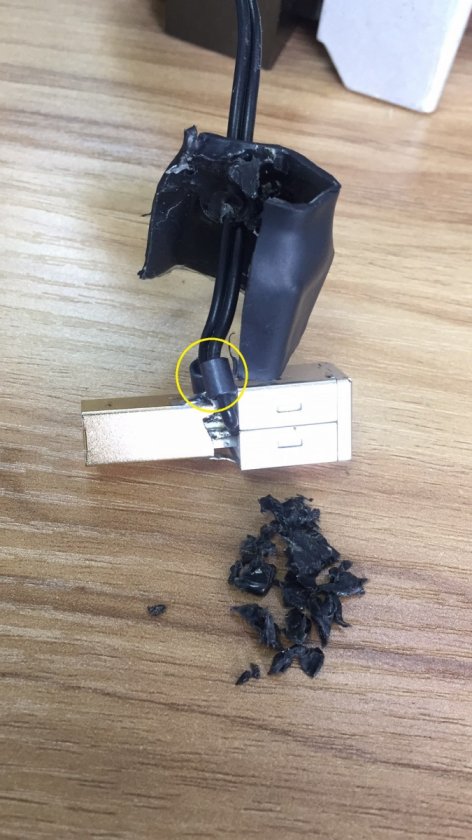

Obviously the ZIP R4W005-100 comes with a DC connector, the AQVOX comes with a homemade USB male and female connector.
AQVOX did add 2 ferrite beads to the power lines and gold plated the connectors, good on them. Other then this, it appears that the USB connector was made up of one male and one female, with USB Data pins directly solder together, then hot glued and applied heat shrink tube over.
