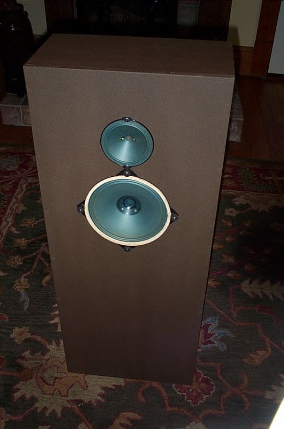

A few years ago, I made a pair of simple five-sided boxes (open back) using these drivers.  I think I just put a 1.5uF Auricap on the tweeter.  They sound very nice, so I'm not sure about midrange shortcomings.  Are these the same drivers that you have?  Maybe we are taking about something different.  :dunno:

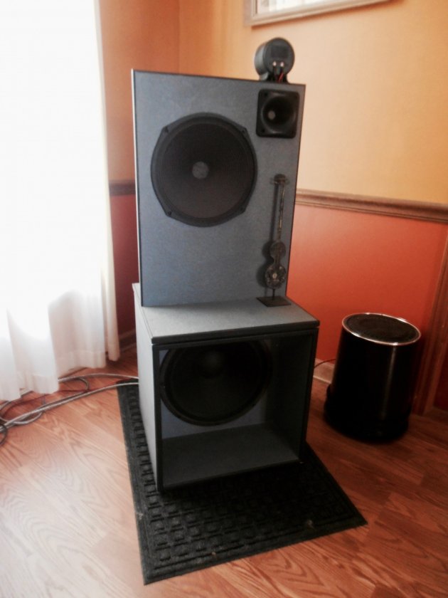

I have 3 way open baffles, using vintage Alnico drivers
High frequencies are handled by a Grundig 3.5" Dew magnets
Midrange are circular 8" Greencones  - the version with the strongest Tigges magnets
Base are 15" Altec 416A VOTT drivers
I am very happy with the high frequencies and base, but feel the need to see if the Greencones can be improved on. As you can see, the use of a whizzer driver is superfluous and they introduce distortions. The 6-8ohms impedance is to match the other drivers.
Mine are very similar to yours :)

I think your midrange problem might be a level matching problem.  I don’t see your Altec 416A’s so don’t know how you have them implemented, but they are a 99dB, 16 ohm speaker.  I can’t think of many readily available 8” or 10” drivers that can cleanly produce 99dB throughout the entire midband.  My first choice would be an Altec 414A 12” driver.  It is one of the best midrange drivers ever made, and runs with no crossover at 99dB up to about 4Khz or so.  You’ll have to look for this secondhand, but it is well worth it (and a bargain at about $400 a pair).

Mine are the more rare 8 ohm 416s so matching is not too bad. I will have a look at that 414A. Thanks

If you take a look at the impedance curves for the 416, you are problably up around 12-16 ohms if you are crossing over at 200hz or so.

But in the case of the 416, the impedance curve looks like a shallow U.  The impedance trough is from about 200-700hz, rising gently below and above that range.  Some amps may put out more power into lower impedance, while some tube amps like higher impedances.
