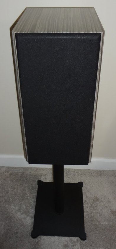

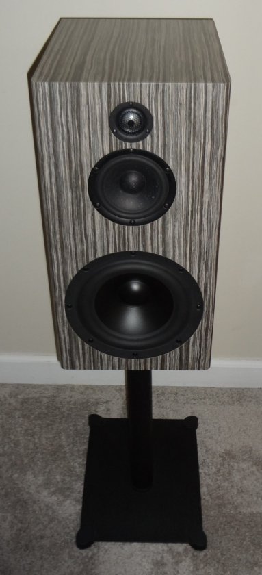

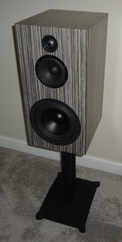

More pictures...

Is the grill held by magnets below the veneer?  Love this speaker!

Yes, embedded neo magnets. I love it too!

Any comments on the sound? What stands are you using for the photo op?

22" tall Sanus stand. I'm biased on the sound since I designed it - Nick can chime in later.  :)

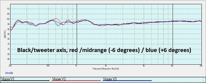

Rick, what height stands do you recommend for this monitor?
Thanks, -dGB
Here's a vertical response set of curves. As you can see it's very uniform and flexible for stands 18" to 24" tall.
