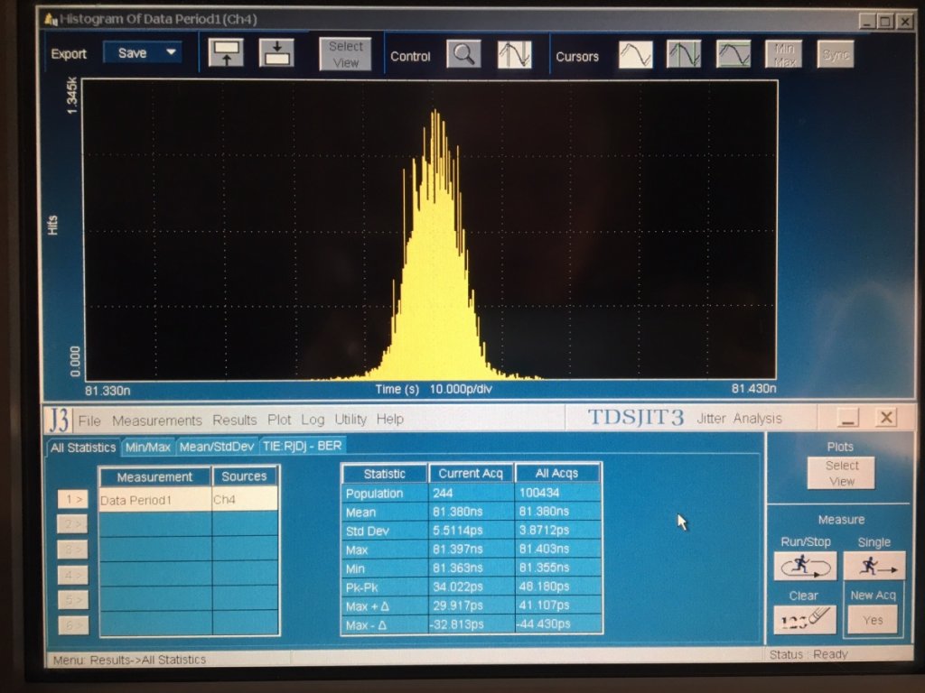

This mod to the SM involves replacing 3 chips.  Reduces jitter from ~22psec to ~7psec.
Comparing the original version to this new version is clearly audible.  Much more 3-D and lifelike.  It's clear that reducing jitter to extremely low levels is necessary.
Measurements were done with Sonos driving the SM using a Standard BNC cable and using a Standard BNC cable from SM to the Scope.  Powered by the supplied 9V Wall-Wart.
Listening tests were done using  Sonos to SM using a $20 BNC cable from Markertek and a Reference BNC cable from SM to the Overdrive SX DAC.  Since this sounds so good with the cheap input cable, this mod may have made it less sensitive to the input cable used.  More testing will tell.
Jitter distribution:
Notice that the two peaks have changed to one peak.  This indicates that it is NOT the difference in rise and fall time or pull-up driver strength versus pull-down strength as I previously suspected.  I believe the ever so slight asymmetry is probably due to this.

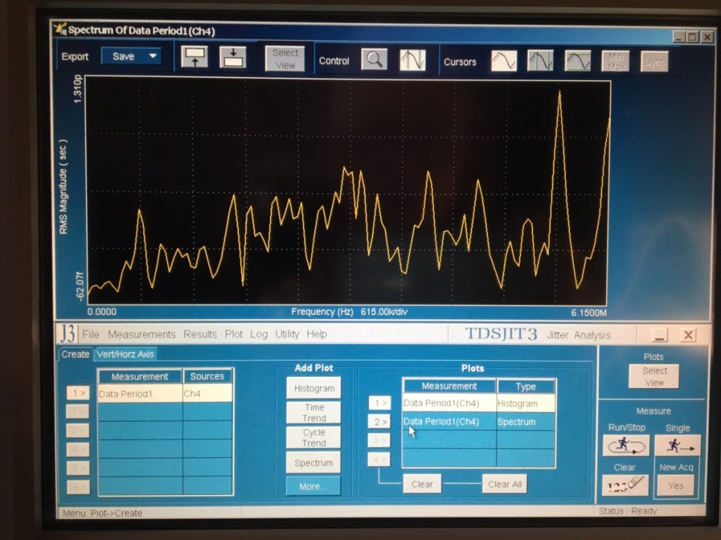

Jitter spectrum:
Not quite as good as using the Dynamo supply, but very good anyway.
