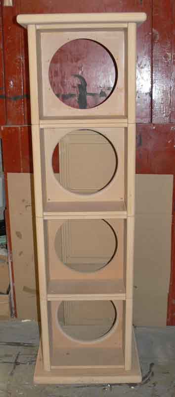

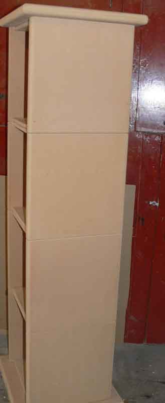

We also have a modular design, here are a couple pics of some quads.
No worries man, was  just  clarifying as that was  kind of the way it came out... but I get it.
Unfortunately, the modular design will run be a similar amount of  money.  I know our  module design has cut the costs   of these rougly in half from  a previous modular design.
These modular  subs  are cut  from 1.25", 1", and .625" Medex.
