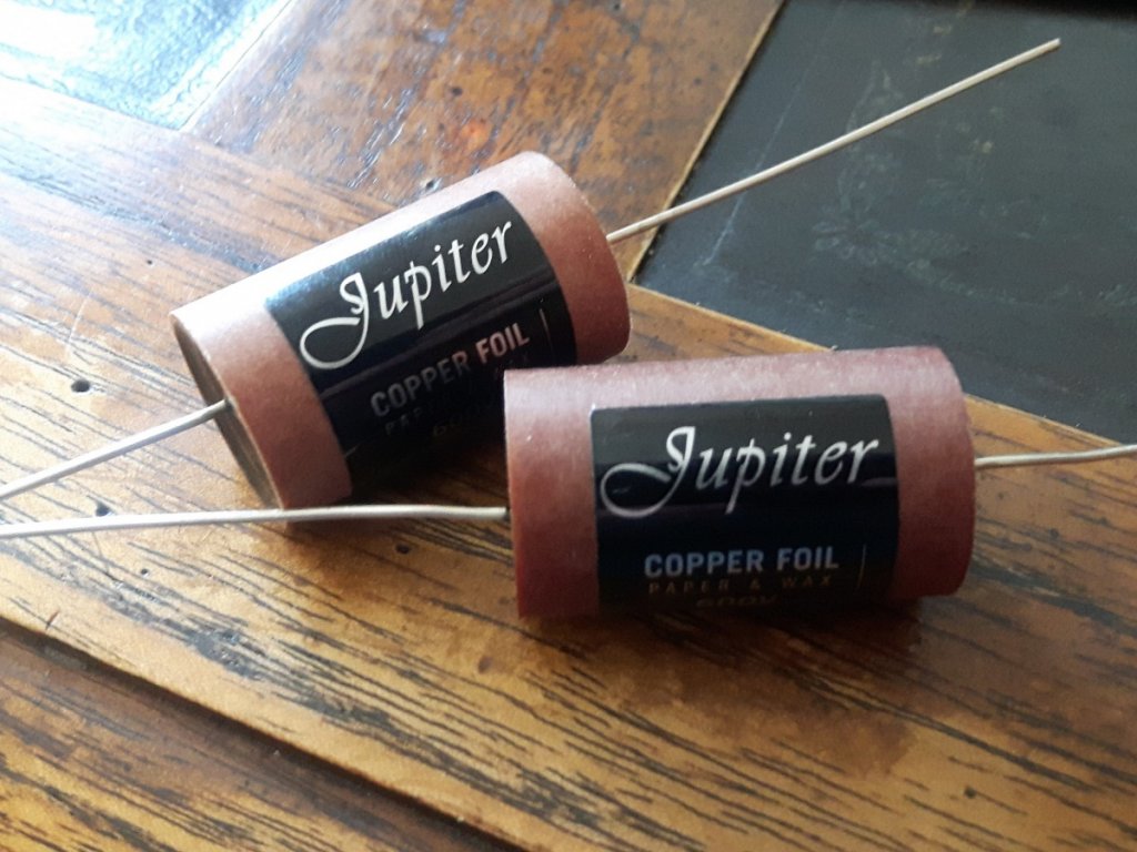

Alright, so coupling caps are in now.

Re: the Jupiters - nice choice!!
They go through a fairly long break in.  At first they sound flat and hyper detailed.  For about 30 hours.  Then they sound dark and veiled for another 50 hours or so.  Then they should just "OK" but not great for the next 100 hours or so.  After that, they bloom and sound amazing.  Just be patient!!  :thumb:

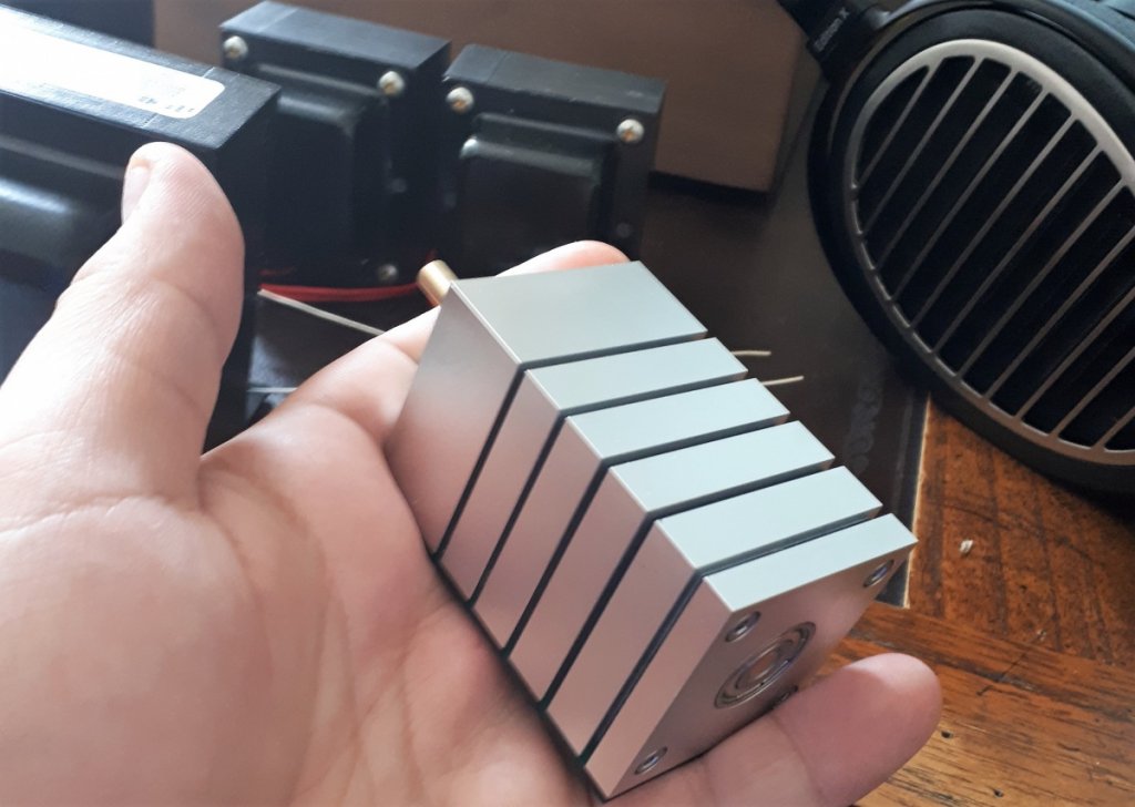

I've received most of the parts I am using in this amp now. I decided to go with a different volume switch than my own this time, one that has many more steps while still being a ladder attenuator.
It's very nice feeling and has a very large range of attenuation (did I mention it's also HUGE  :lol: ).

This looks the Khozmo? I also use it, the 100k log.
It is Khozmo. They make a solid attenuator for a good price and carry ladder types now, so it was an easy choice for me :)
