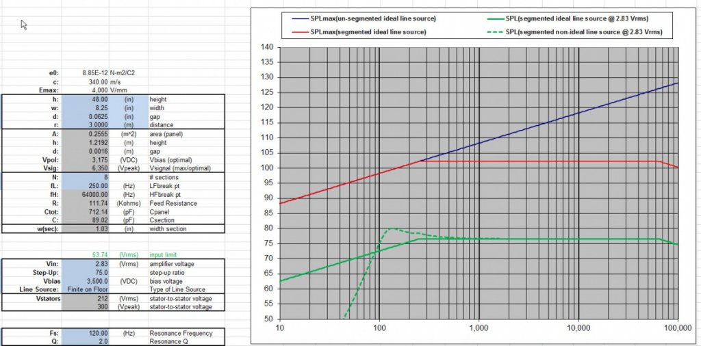

I've heard the Carver ribbons at Carverfest... the sound great but they do need a stout amp.  Most people cant believe how loud my speakers can play.  As a general rule, hybrid ESL's with close diaphragm to stator spacing (like mine) can play much louder than [let's say] a Quad 57 or 63.  And mine are very efficient (even for a hybrid) because the wire size and spacing yield high field density and optimum open area (42%).  I haven't measured the SPL myself but they can play to painful volume.  The 102 decibels I quoted was derived with Steve Bolser's ESL Calculator Excel spreadsheet (see screen shot below), which I used to determine the segmentation resistor values.  The green lines are panel frequency response and SPL with @ 1 watt input power at 3 meters.  The red line is max potential output at 3 meters.  Of course, the mechanical portions of the speaker won't produce sound out to 100kHz but the driving electrical output feeding the wire groups can extend that high.
