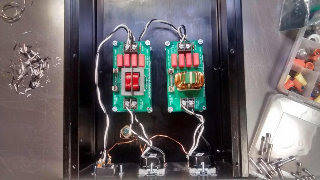

What is going on with the Green wire from the Power socket input in the above photo. Is it attached to a ground screw to the chassis then to the plug ground?
Folsom
Re: New Felix Power Line Conditioner “FO-Felix”
« Reply #41 on: 9 May 2019, 01:39 am »
Yes. We call it safety ground.

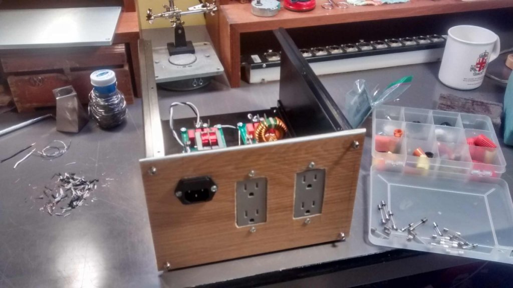

Between busy season with work and family life I worked little by little and finally finished my Fo Felix. I put it in line last night right after I completed it and my jaw immediately hit the floor. I was shocked at the improvement this power conditioner made in my system.
My wife really had no idea what I was building in the workroom, all she knew is that it was “some sort of power cleaner”. I went upstairs and asked her to come down to the man cave for listen. She also immediately noticed how good it sounded as I played familiar songs from the digital portion of my system. I added my previous garage sale Furman power condition in line to show her the difference, within seconds we could hear unpleasant sound compared to the FoFelix. It was flat, harsh and fatiguing compared to the Fo Felix. My wife and I both notice how the Digital FLAC files sound more analogue, like when I play my records. I kept on mentioning how smooth it now sounds. The instruments and reverbs popped and everything is more dynamic and detailed, the Bass deepened, the sound stage deepened. I am really blown away how important a good power conditioner really is. It kind of sounds a little crazy that a quality power conditioner can do this, but it seems to be true. This DIY Project took my system to a level I was not expecting. Thank Jeremy, another super fun and rewarding build. (Looks like I have to trim the Back panel to straighten it a bit)
Digital setup is:
Laptop / Foobar 2000 running All FLAC Files > USB to ifi DAC2 with ifi USB Purifier 1 > Promitheus Audio Dual Mono TVC > Folsom Amp > Spatial M3 Turbo S Speakers

BTW you don't need fuses on the larger Bourn inductor. It doesn't do anything unless the resistor is tied to it (something on the earlier board that protects the resistor, the later boards didn't need it, I'm not sure which revision you have).
Did you plug the laptop in, too?

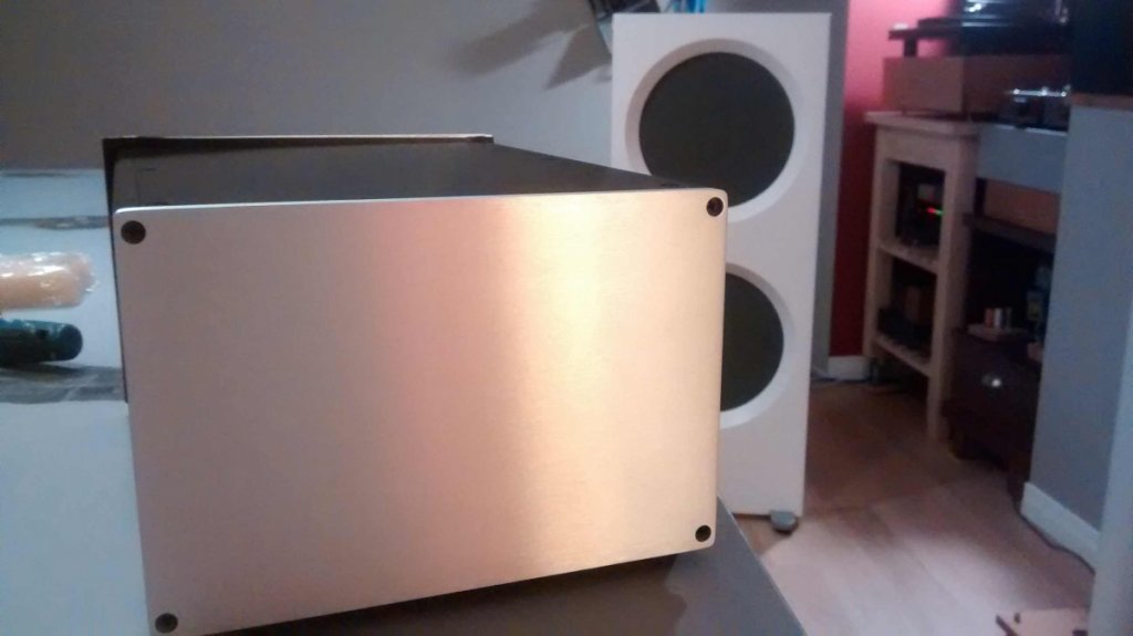

Finally assembled my Fo-Felix.  19” x 10” x 3” box. Still have to apply finish to the wood sides.
Folsom
« Reply #53 on: 1 Mar 2020, 11:31 pm »
Looking real nice!
