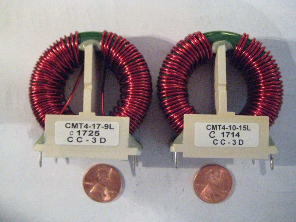

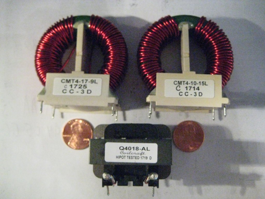

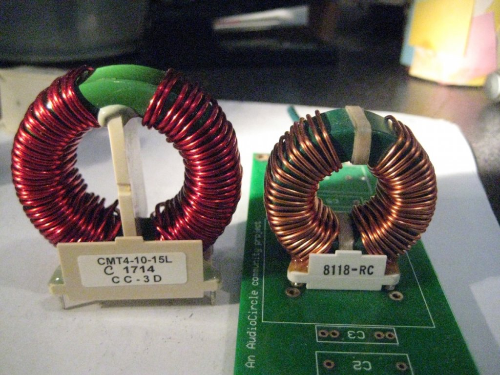

BTW. I currently have four Coilcraft CMT4's. Two 9-amp coils and two 15 amp coils.
I wonder if anyone on AC has experience with the CMT4's compared to the Bournes and smaller chokes by Coilcraft.
Attached are a few pics of my CMT4's. They are much larger then the coils used in the original Felix.
Due to the larger size the pin spacing is 1.500 by 0.900 and may not fit your board.
However, It would be interesting to see how many folks would be interested in trying the CMT4's with your new board.
Maybe if there's enough interest in the 4's it would be worth modifying your pcb if needed.

No, AB. I'm using 2 Adcom GFA 555's early 1986-87 mark 1's. Fuse is 10 amp.
ha, no. It's more like a 20A CMC. The fuse might be 10A, but the amplifier doesn't use that.
Folsom
Re: New Felix Power Line Conditioner “FO-Felix”
« Reply #11 on: 11 Apr 2018, 05:47 am »
The advantage of using the CMT4 is that it won't saturate quiet as easily. But at 15A is is still somewhat limited. I'm looking into Wurth right now because they go even higher by using a nanocrystaline core that doesn't have to be so big.

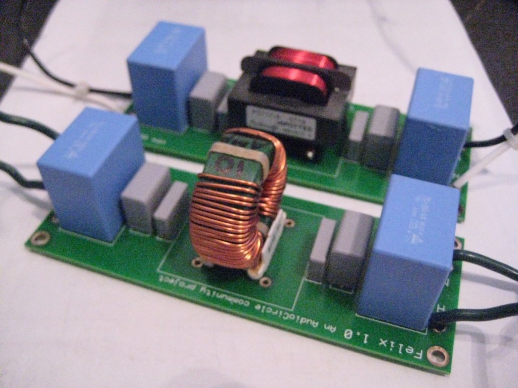

I have a bajillion Bourns 8118 (9.3A 7.3mH) lying around from the original Felix. Can these be used instead of the 8120?
Folsom
« Reply #15 on: 12 Apr 2018, 10:13 pm »
You could probably force the pins with very little effort.  But I am going to say I do not condone it as it circumvents Folsom's built in safety for ampere concerns, so at your own risk knowing there is no fuse, and it does not match a 15A socket. So as long as you are not trying to use too much current, it would work.

It would be great if we could source good boxes etc. as well.  I found that to be the hardest and most time consuming part of building my Felixs.  I ended up having cord in / cord out with a steel box in between, like a snake that just swallowed a box.  I think it would be safer to have built them with IEC in socket out.
I have 4* Dodd 120w tube monoblocks and I use one for each amp.
