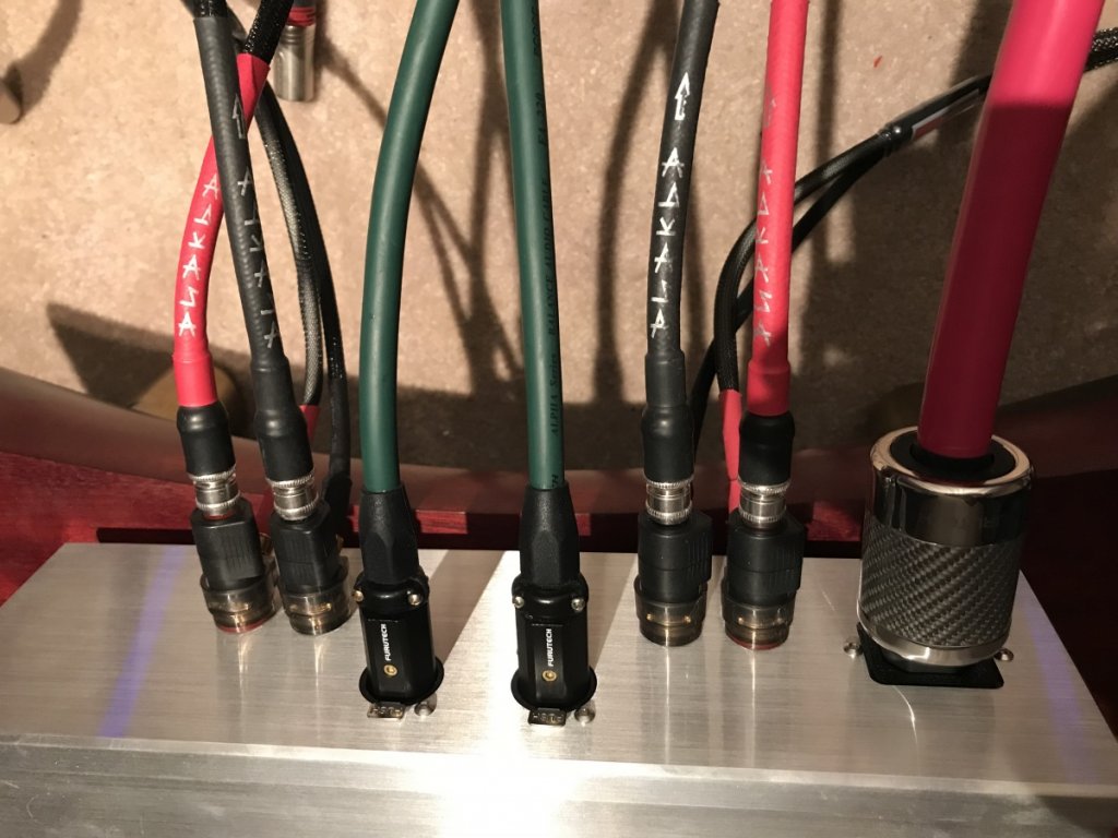

My actual first time listening to the DPS-4 power cable on a fully loaded SE with DPS-4 internal cable (non-anodized). All I can say is this is insane. A total new level from how it sounded with Jay’s Takachi case with Schurter inlet. I’ve never heard such a profound difference from a power cable. And the one it replaced was a $1000 cable!
