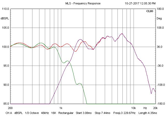

Sadly, that's exactly what I have come to expect. Iron core 18 ga inductors, cheap poly caps, sand and wire resistors.  I know AJ in Fl did a fine job with those 100 woofers several years back.  I'd love to hear what Danny could do with them.
You may have already seen this, but this is a F/R graph from an Altec Valencia reworked by Danny a few months back.  Those big woofers and horn are not easy to tame.  Lots have tried.
