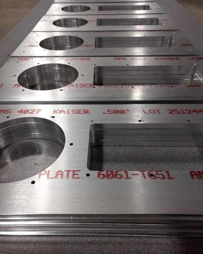

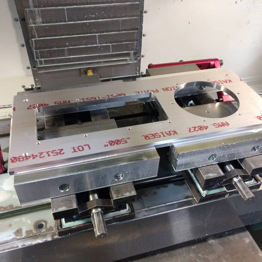

The Ruby has been a hit both in performance and in looks. The new tweeter is amazing with the hybrid crossover. And the aluminum faceplate plays a real role in imaging.
You can see below the aluminum plate for the EDDIE LE. It will also feature the black gloss cabinet like Ruby. What else is new are some tweaks to the woofer, hybrid crossover and mid-tweeter panel. The new tweeter is a planar. It sounds really good.
So I have the drivers and faceplates just need polished and grained. The cabinets are on order. Did I mention on order? I really dislike cabinet guys - they can be so flaky!

The picture below makes me so happy. These faceplates are REALLY expensive. Anyone who has worked with CNC and metal and finishing knows that. This is 1/2" American aluminum. You are seeing it before the finish is completed.
I don't charge markup on this faceplate. It's included with Eddie at cost. A pair of them would increase the retail price of the speakers by over $1000/pr. The performance is so improved I'd rather take a hit than compromise the sound...

Is a countersunk rebate to flush mount the drivers yet to be machined, or are the drivers going to be surface mounted?

That's a great question. They will be surface mounted. If we avoid the debate on the differences between flush and surface for now - let me explain several things we looked at.
When we tested various prototypes there were pluses and minuses to both approaches. Currently we machine the faceplate on one side. To do flush, the rear machining is actually about twice as hard as the front. First, the F118 needs to be broken down into naked drivers - no problem. Then they get mounted from behind. They have to be torqued down to bond them to the frame. As the aluminum is soft for that kind of application that means welding a nut for all mounting points. ARGH. Then there is chamfering the face etc.
The current benefit of the surface mount is that when the drivers are bolted to the aluminum the structure becomes rigid and resonance free. It's seriously solid.
One of my goals for Evoke is to offer high performance at a reasonable price. Trust me, I considered this. I also thought a matching aluminum back plate would be awesome. But when you add all this up you are talking a retail price in the $7,000's plus. The math of business is isn't fair.
