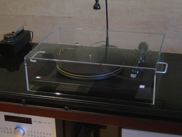

Here's mine......
How did you add the handles? Is it adhered by glue or are they somehow screwed in? BTW, it is possible to safely screw into acrylic without cracking it?

spence
Re: Affordable Dust Cover
« Reply #42 on: 4 Nov 2020, 07:21 pm »
If I remember right, I got the handles at Lowes. They're just screwed on. I used blue painters tape, marked the holes on the tape, then put the tape on the dust cover and drilled the holes with a regular drill bit, being careful not to apply too much pressure. Take your time, and use a tiny bit to start a pilot hole first, so the larger bit doesn't slide around and scratch the acrylic when you start your final hole. Place the dust cover on it's side, keep your drill straight up and down to avoid it sliding,  and drill from the inside.
wdlvwdlv
  • Posts: 63
« Reply #43 on: 4 Nov 2020, 08:30 pm »
I just noticed the deck beneath the cover, how do you like the Mofi deck? I was thinking about that one but ultimately got a better deal on a Pro-Ject 2xperience SB. I always wondered what the other deck would have sounded like.

spence
« Reply #44 on: 4 Nov 2020, 09:11 pm »
I love the thing. It's simple, tracks great, and sounds rich.

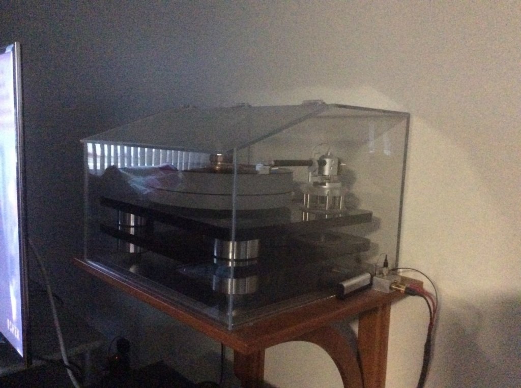

drummermitchell
« Reply #46 on: 4 Nov 2020, 11:41 pm »
Had mine made at a acrylic shop that makes displays.
Price was about 130.00can.
Had it made so the cabling and pc had access cutouts and also the front top was cut at an angle so I could change LPs without having to remove whole cover,which also is a hinged
wdlvwdlv
  • Posts: 63
« Reply #47 on: 4 Nov 2020, 11:57 pm »
Wow 🤩 can you let members know the vendor. That’s pretty nice work with all those extras! Thank you.
