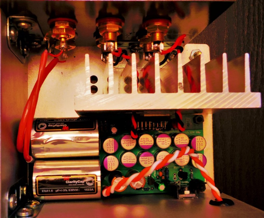

In building the Folsom amp, I understand quality of results vary considerably with the choice of caps used.  What caps would some of you recommend I order/use?  I lean more towards the "cheap and cheerful" approach as opposed to "no holds barred" .  Let me say my caps budget, for the amp and the anti-pole, is $50.
Pete
lacro
  • Posts: 602
Re: I put together the little Folsom amp.
« Reply #93 on: 20 Jun 2018, 12:43 pm »
Pete
I am happy with Clarity ESA caps.
https://www.partsconnexion.com/CLARITY-74834.html
Pete
Since the value needed is quite small, it is worth spending a little more to get high quality caps.
I like the Jupiter caps and Sonicap Platinum's myself.
