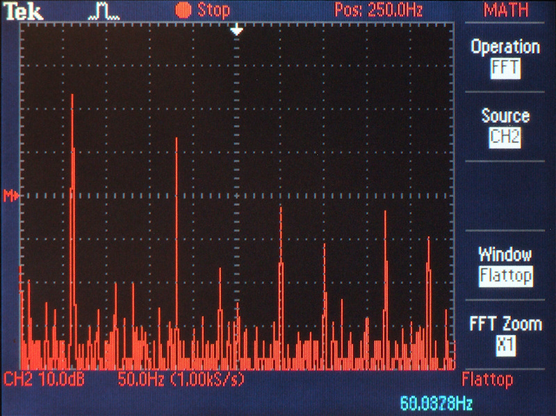

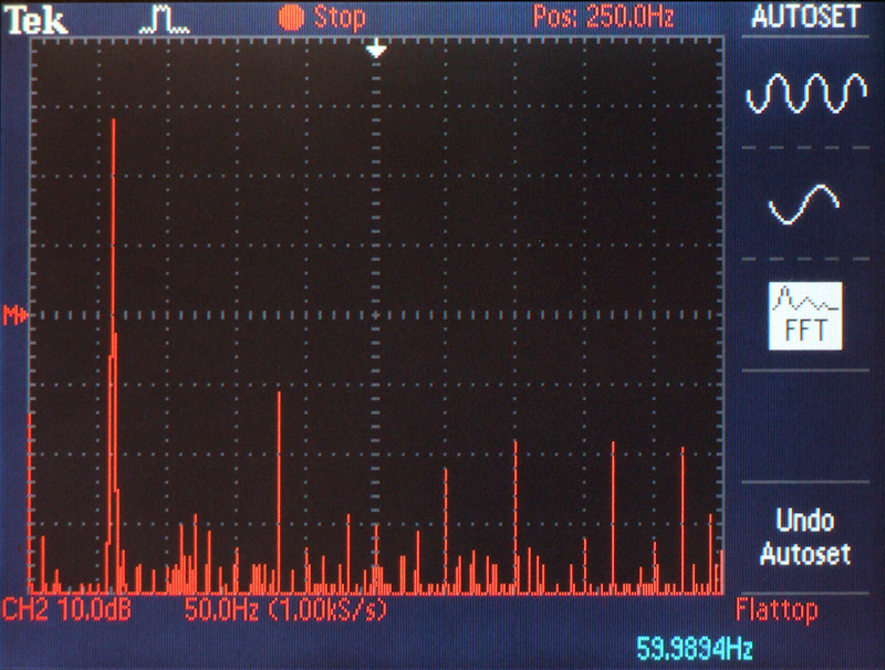

Figure 10. FFT plot of passively filtered open circuit AC voltage from the wall. The only signal of value is the large spike on the left, which represents the 60 Hz power signal. Everything else is harmonics, the power company's 470 Hz signaling tone, and noise.
Figure 13. FFT plot of open circuit AC voltage measured at the output of the iFi Audio iPower switch mode power supply. No even order harmonics were generated, but the odd order harmonics are significantly greater in amplitude in the voltage from both the wall and the AC regenerator.

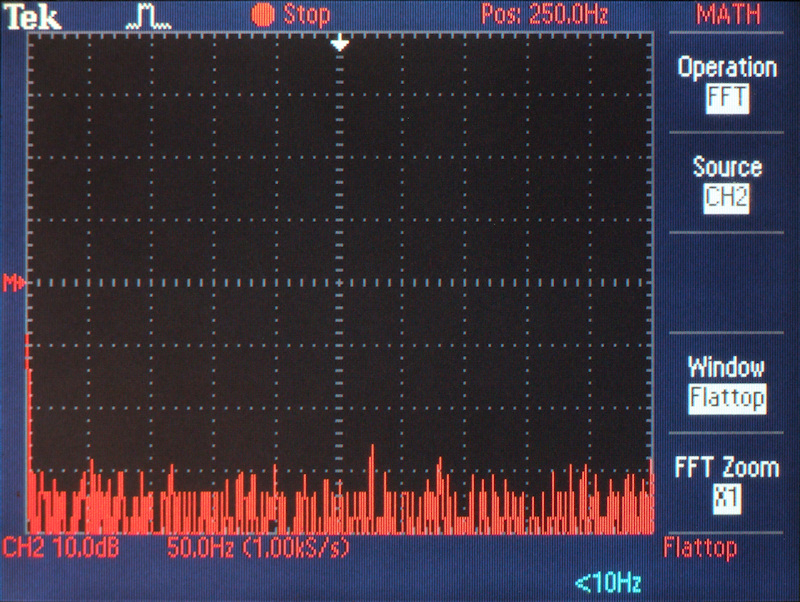

Figure 14. FFT plot of open circuit AC voltage measured at the output of the TeraDak LPS. In stark contrast to the switch mode power supplies, no AC artifacts at all.
