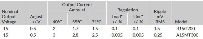

But if all you need is pure clean linear regulated power then pick up a used Acopian B15G200 on eBay for $55 - $65.
The A15MT300 will give you a little more headroom and has tighter specs for a little more. You can also order new for a lot less than $500.
Acopian power supplies are made for 24/7 industrial use and will outlast any electronics you plug them into. You will need to make your own connector and power cord but that is super easy.
