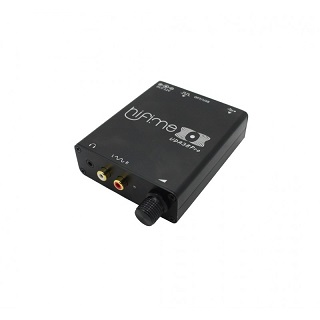

Hifimediy just released their new DAC for only $249. It's the only ES9038Pro DAC I'm aware of at that low a price. I've been saying how the DAC cycle just gets faster and faster, so this is no surprise.
But there's no free lunch: No Xmos or Amanero boards, so no DSD 256+. Uses the new-ish OPA 1622 headamp, but only one so performance will be limited. No HD650s for this one without a separate amp. Also power hungry and internal power regulators don't look all that impressive but we'll see as they release more info.
This is a pretty basic unit, so no bells and whistles. Frankly, I'm kind of meh about their DACs in general, but still, it's $249 and an ES9038Pro. The next cheapest ES9038Pro with USB I could find is $450 on ebay.
Hifime had only a limited supply to sell before Chinese New Year cut off and those are all sold, so it will be several weeks before they have more in stock.
Yes, I got hold of one of the limited units  :wink:

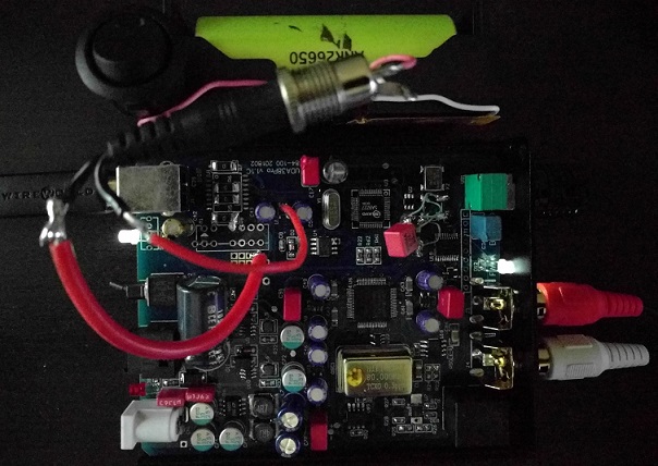

After poking around inside the Hifime I of course decided to mess around. Got in over my head, per usual. I removed what I thought to be the main voltage regulator feeding the usb receiver clocks and patched in a 3.3v Lifepo4 battery instead. The bad news: I somehow I cut off the 44khz signal. The good news: 96khz works and OMG, sounds so f*cking good. Why oh why don't these guys make their dacs with an option to use a battery direct to the clocks (I mean direct, as in no battery packs with noisy regulators of their own). It is so easy to do with the right layout and the sound quality jump is insane.
So now this dac sounds sublime. I'll let Windows handle 96k upsampling for everything. Worthwhile trade-off for what I'm hearing now.

Interesting. Did you use that vattery ps fin eBay that you linked before?

No, although that looks like a great start to match with an iDefender. I have a bunch of A123 Lifepo4s I used in other projects. Popped one in a little holder, added a switch and then wired to the board.

I see that this device has an optional power supply input. Does using a dedicated input change the noise characteristics or affect the sound signature? The website mentions only that external power supply will provide higher power and voltage outputs. It doesn't mention if using the external power supply switch over the device from USB powered mode.

I believe the external supply primarily impacts analog and DAC related clock and ICS. As stated on the website, USB still draws about 100mA even with external power. This is for the usb receiver and receiver related clocks and ICs. Not sure if there is true separation. I think there may be some blending when using external power.
But here's the catch: Regardless of USB only or external, there is a pretty noisy regulator that converts the power to +/- voltage for the opamps. There's no way to avoid it. And since the USB power gets used to some degree no matter what, you have to make sure it's clean. So my experience so far has been the DAC sounds best just using the USB power with an external 5v PS attached. Using both USB and external increased volume output, but did not sound as good since I could provide clean power to only the external and not the USB. Unless you have headphones that need a lot of power I would focus just on the USB for power.
