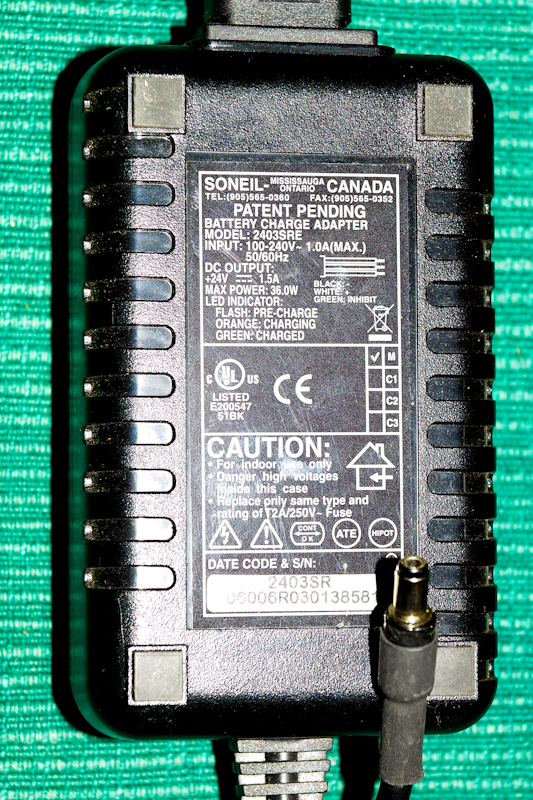

Have been using it in the stock configuration with four 12V 5Ah batteries and with the
charger shown below..........

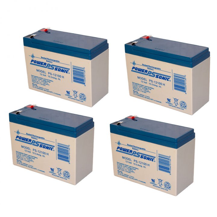

.....was wondering if one could substitute four of these (12V/10.5Ah) ....
....to increase the run time ? Obviously the set of larger batteries would need to be
external with pos and neg leads to the chassis . Would the Soneil charger have any
issues charging the 4 larger 10.5Ah batteries ?
So long as they are external you can use them.
I don't think the charger will have any issue with the larger batteries.

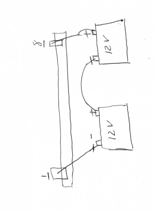

I like the idea of two vs four batteries .
But I am a little lost as to how one would connect 2 batteries in series looking at the attached pic .
Would a short wire be needed between 2 and 3 as well as between 6 and 7 ?
Or is it as simple as connecting one battery to 1 and 4 . And the other battery to 5 and 8 ?
Sincere apologies for the elementary questions  :?
And thanks for the help  :)
Bonk
Bonk,
Position 8 is the positive connection to the amp and Position 1 is the negative connection to the amp.
To connect the external batteries in series, the positive post of one battery is connected to Position 8.
The negative post of that battery is connected to the positive post of the second battery.
The negative post of the second battery is connected to Position 1 in the amp.
Here is a pic:
Bonk
Thanks Mlundy .
That's exactly what I needed to see !!   :thumb:
