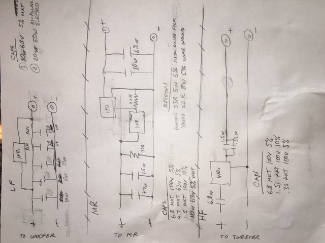

--At middle of the left side of the board in the pic, the High Freq section currently has one Vishay MKT1822 1.5uf 100VDC cap; one Vishay MKT 1822 .33uf 100VDC cap and one Vishay MKT1822 6.8uf 100VDC cap.
--At the top left corner, the Mid Range section has one Vishay MKT1822 1.5uf 100VDC cap and one Vishay MKT1822 4.7uf 63VDC cap.
--Across the right of the pic from bottom to top, the Low Range section has three unknown brand .6R MKT caps marked "10J60" right at the take off to the woofer, then two Bennic Bi-Polar 20mfd 50W electro caps, then one unknown brand 6.8 MKT cap marked "J100" then another unknown brand .6R MKT cap marked "10J60".
--All caps are bypassed with Vishay MKP 1837 .01 under the board.
Objectives: to improve the definition, detail, openess, spaciousness and imaging without damaging the listenability, body and smoothness this speaker is noted for. I have always been very sensitve to glare in a system, so need to avoid it at all costs. I think one might describe the kind of sound I seek as being close to a vintage tube sound, picking up the sweetness, body, tone and texture but avoiding the closed-in, lack of detail, lack of dynamics that "vintage" might connote to some.  I would like to find the most-leveraging improved passive components to achieve this.  And I would like to have them fit on the current crossover board.  Would also like to achieve this with an eye toward diminishing returns. I don't have an interest in cost-no-object solutions, as I have found in the past that (for me) they are usually not worth it.
Mission impossible?   :icon_lol:
Based on my research, as a way to start the conversation, and give y'all something to react to here is what I am thinking might be one solution:
1. All Sonicap Gen 1 Caps, use Russian PIO's (that I have on hand) as needed to tailor the sound.  Cost would probably be under $80 for both speakers.
2. Bypass Sonicaps with the existing MKP 1837 .01's as suggested in the Humble Homemade HiFi Cap Survey (or has he moved on to the Cornell Dubilier 940C for all bypass applications?--in which case I may try those if y'all think worthwhile).
3. Use Mundorf M-Resist (replacing their steel legs with copper wire) to replace the two resistors.
4. Not sure if anything need be done with the inductors or even how to know what value the current ones are.
I welcome all feedback.  Thanks so much!

I enjoy a pair of Spendor S-100 speakers driven by all tubes: Mac MC275; Mac C2200 Pre-amp; Line Magnetic tube DAC.  The drivers are a 0.75" soft dome tweeter crossing @ 4Khz to a 6" polypropolene mid which crosses over to a doped bextrene woofer at 600Hz.
Hello, welcome to my circle.  I would love to hear how you arrived at this system over the past 10 years, looking back at your older system.
As you might be able to see in the pic below:
After years in the industry, this has become a pet peeve for me.  I do not want this to (nor do I believe it will) discourage others from speculating on your proposed project.  While a pic is necessary to consider what (brand/type component) is there when plotting the map to your desired result, it is not a substitute for a schematic.  I have a few Spendor schematics, but no S100.  The closest thing i have is a SP100.  Looking back at your previous posts, a simple schematic should be nothing for you :wink:
Was this factory, or did you do it?  If you did it, what was the result?
improve the definition, detail, openess, spaciousness and imaging without damaging the listenability, body and smoothness....picking up the sweetness, body, tone and texture but avoiding the closed-in, lack of detail, lack of dynamics...
Would you like the next winning powerball #s with that :o :lol:
 :scratch:  There are a few conflicts here.
Mission impossible?
Perhaps.
Given your multiple references to budget, do not keep us in the dark.  What is you proposed budget?
How did you come to this?  Which Russian PIOs?  Are you referring to Mundorf Supreme resistors, or...?
We can measure those inductors for you free of charge.  We would even draw the schematic if you sent the board :D

Thanks for your interest.  Here are the answers to your questions.
How did I evolve to this system?  Since my first real job out of college (late '70's) thru much of my audio life I was in love with planars and electrostats.  They project a presence that cannot be denied. Believed in high tech, built a couple of Class D amps.  Didnt really trust tubes. Always solid state power amps but a couple tube preamps by Audio Research and CJ. By the early 2000's I felt I was always chasing satisfying sound but never getting there.  Went through a complete reappraisal.  And put together one of the more satisfying systems with Vandersteen 5As and tube monoblocks.  Realized I found the old dynamic box speakers to be more satisfying and musical.  Esp. British voiced speakers and Vandy's. And as I moved to McIntosh the tube reliability was there.  Not the latest and greatest whiz bang but unlike the SS and electrostats never amusical, annoying or leading to a fixation on the damn equipment.
Schematic  OK will have to pull the board (not fun) to trace the traces, but can do.
Did I update and bypass the caps?   Yep. The MKT1822s on tweeter and midrange I changed out and then did the bypass caps as well.  It was an improvement.  Nothing earth shaking.  I would say less grain, a bit more detail, a bit less closed in.
Conflicts?  I'd rather say some of my stated needs engage in healthy competition. But thats how we'll get to a robust and balanced solution.  Besides seems like the most efficient way for all the fine folks here to understand where I wanna go with this.  C'mon buck up!  We can do this!  :lol:
Budget  I would say less than $500 unless someone is really persuasive re: the next big leap is just another hundred away...  I have seen too many posts where folks are spending thousands on xover caps alone.  That used to be me, but I'm older and wiser now.  Aint I?   :?
How did I arrive at my Strawdog   Obsessive review of posts just like this one, going back to 2005.  And put through my particular screens: looking for where the diminishing return curve flattens; avoiding anything called etched or detailed or fatiguing; trying to triangulate from many opinions something that conforms to how I hear; knowing that striving for the nth degree of detail or transparency often works at odds to musical and satisfying (as my journey with electrostats and solid state taught me well); not needing the BEST! as there is no best, only what works with my ears and my system.
Measure the Inductors?   Hey you didnt even tell me I needed inductors yet!  Can I measure them?  No advanced weapons here, but do have a good Fluke VOM and an ammeter.  Hate to be without the big spendors.  TX is so far away!
Hope this helps -- Rob

Missed one component in the crossover.  There's another resistor that was hidden in the shadows last night.  It looks to be in series with the resistor listed above. But its smaller, has a black cover and looks like it might be a wirewound.  I can not see a wattage on it or a brand.  Can see three lines of print.  First line is 58 ER, middle line is 33R  J (indicating 33 ohm @ 5%) and bottom line is 8843.
Makes sense, and thank you for sharing, but I was more interested in how/why you went from the stock or modified 5As to the S100.
Schematic
Great.  I look forward to helping :D
No perceivable shortcomings?  No two steps forward, but one step back?
 :icon_lol: I'm not quite sure I follow... :scratch:  In any event, you mentioned budget, fit it all on the board, diminishing returns, etc...  In the same post, you also say that you are after "improve the definition, detail, openess, spaciousness and imaging without damaging the listenability, body and smoothness....picking up the sweetness, body, tone and texture but avoiding the closed-in, lack of detail, lack of dynamics..."  That is a pretty damn tall order :o  And just when I thought you had asked for it all, you deliver the coup d'etat!  "I would like to find the most-leveraging improved passive components to achieve this"   :lol: indeed!
I hate to say it, but the parts that yield the greatest application specific delta (what you are asking for), will neither be cheap, nor fit on your board.  Further, such a golden recipe is unlikely to come from the speculation and debate of hobbyist on an audio forum.  No expert would be 100%.
The solution is simple.  You are merely trying to please yourself.  You alone will know when you are there.  Much R&D would get you there, but it would be expensive.  I believe you would consider this a waste of money.  I consider it buying an education.  I think we can both agree this course of action is prohibitively expensive.  I am here to decrease the price of your education.  If you let me. :D
I'd say that is a healthy outlook, and budget.  Even though we do not know much about the XO yet.
Armchair quarterbacking will waste your money faster than...  I find most audio forums contain 50+% misinformation.  Much less being able to derive diminishing returns, etc...  "The best" is application specific, and subjective....what could go wrong? :roll: :icon_lol:
One of a few early observations.  Any cored inductor working above 300Hz, and definitely above 500Hz, are working against everything "you" are attempting to do.   I do not want to put the cart before the horse, but it was an opportunity to kill to birds with one stone.
You could, but not with a VOM.
You are going to have to sacrifice somewhere :cry:
BTW, all dry paper caps contain wax.  And, I would not recommend the M-resist for your application.

atkinsonrr
  • Posts: 27
  • Long time audiophile and tweaker
Re: Request for Advice on Upgrading Spendor Crossovers
« Reply #19 on: 2 Feb 2018, 08:28 pm »
@ Jeff
The reason for selling the 5As was they couldn't fit into my lifestyle.  I move a lot, often overseas.  The system I have right now is right at the limit of what I feel can come with and fit into small digs if I relocate for a year or so.  This is timely discussion, because I am learning I may need to move overseas again, within a few months.  This elevates the importance of my objective of fitting upgraded parts into the speaker cabs (I may have given the wrong impression before when I said "on the current boards").
When I did the modest cap upgrade, I didnt perceive any downside at all.
Per your suggestion, I checked everything with a magnet. Magnet definitely attracted to the resistors.  The only thing else on the board that responded was the frame on the one large inductor and the nuts and bolts holding all the inductors to the board. The binding post hardware was fine.
On your confusion about my needs seeming unreasonable, conflict vs compete, or other non-audio stuff, I PM'd you.
Here's that schematic. Ugly but (I think) accurate!  The inductors I simply showed as boxes.  Lo-Freq at top, Mid-Range in middle and Hi-Freq at bottom.  Binding posts (IN) at right and (OUT) to drivers on the left.  The S100 is (from factory) tri-wireable, so each speaker has 3 pairs of binding posts leading to a separate circuit on the crossover.
