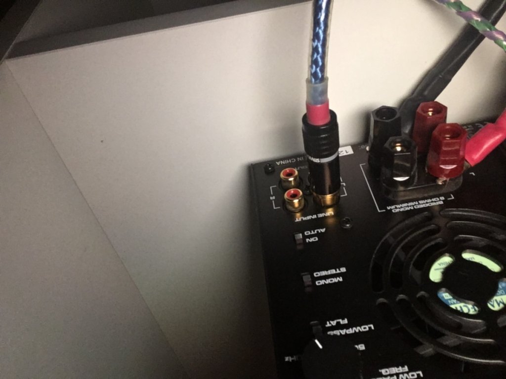

I promised myself that if I touched the system today it would only be to listen, not to mess with anything. So I just tried one little thing, and I'm attaching some photos because you guys wouldn't believe me otherwise.
I tried opnly bafld's suggestion to run the variable line out of the Hegel to an input on the Meier Prehead, then the Prehead's output to the the inputs on the Dayton amps. Not ideal as a long term solution, but I actually started to warm up to the idea of keeping the Prehead around because it's an amazing headphone amp.
Photo 01 shows the purple/gray XLO cable leaving the variable line out of the Hegel.
Photo 02 shows that cable feeding input 1 of the Meier, and right next to it the blue Straightwire leaving the pre-out.
Photo 3 shows the Dayton amp with the blue cable coming into the left input with the amp set to lowpass, mono, and the low pass freq set to the max of 150Hz.
Photo 04 shows the volume control of the Dayton set to max. The light looks reddish but it's blue, and the other Dayton is set up identically.
Finally, Photo 05 shows the Meier set to input 1 with the volume at max.
I should have more bass that I know what to do with, but I still do not have enough to match the output of the Omegas. This just makes no sense to me whatsoever.
