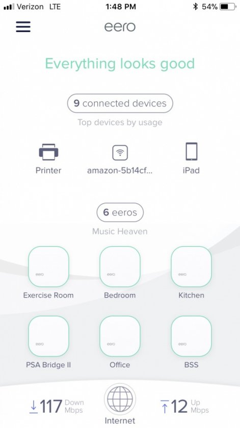

I’m an early adopter of the Eero routers which are a mesh network. Best money I’ve ever spent on my network.  In my old house I had 25+ devices on it all going and streaming DSD and there was no slown or any dead zones.  Flawless all the time.  Even in this small house it works great.
