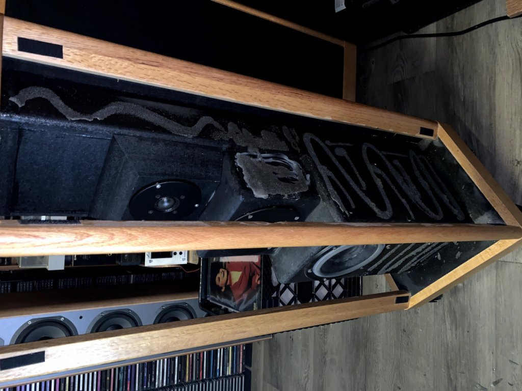

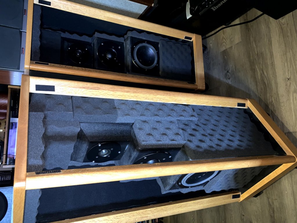

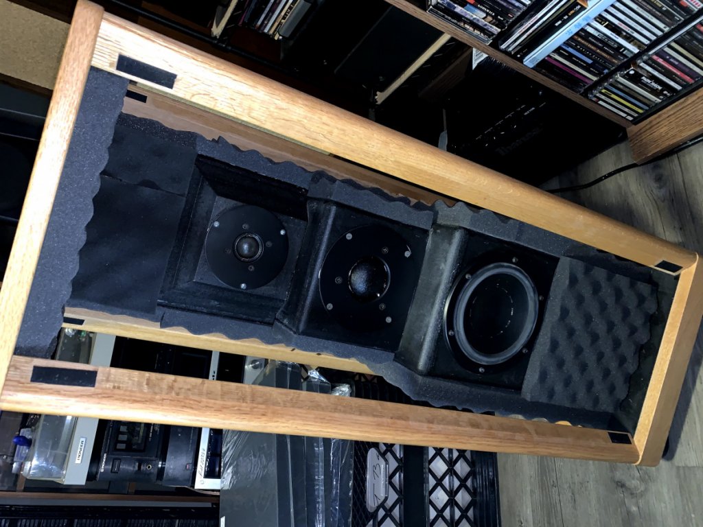

Finally finished restoring the Quartz speakers and figured I'd post some pics as there's little information on the web about them.
I updated the crossovers with larger coils and caps so I decided to mount them on the back of the speakers.
The Quartzs are now living in my classroom which I can safely say has the best sound at the school.
Original crossover and variovent.
Defoamed and emptied enclosure.

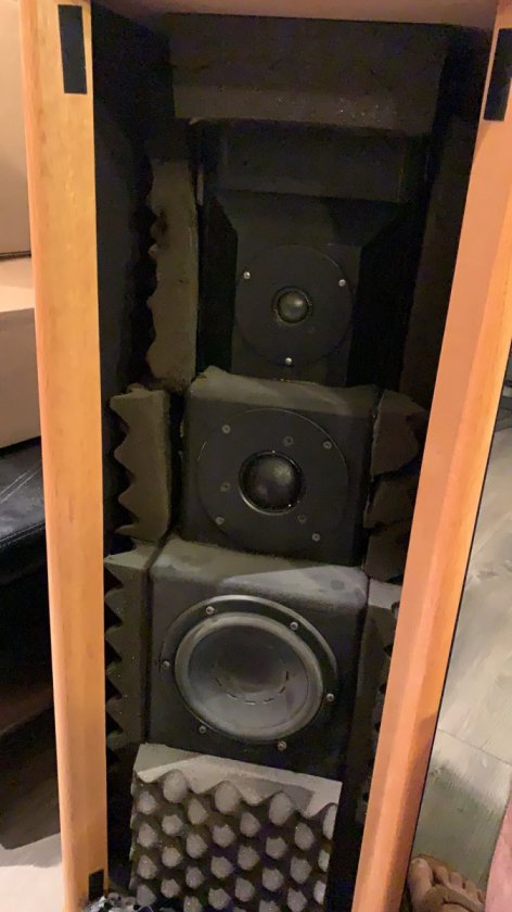

I must thank you for this post, I had a pair of these speakers for three years and I have yet to find any information about them. I did not do much to them except for replacing the foams on the outside of the speakers. Please share if you have completed your restoration work.

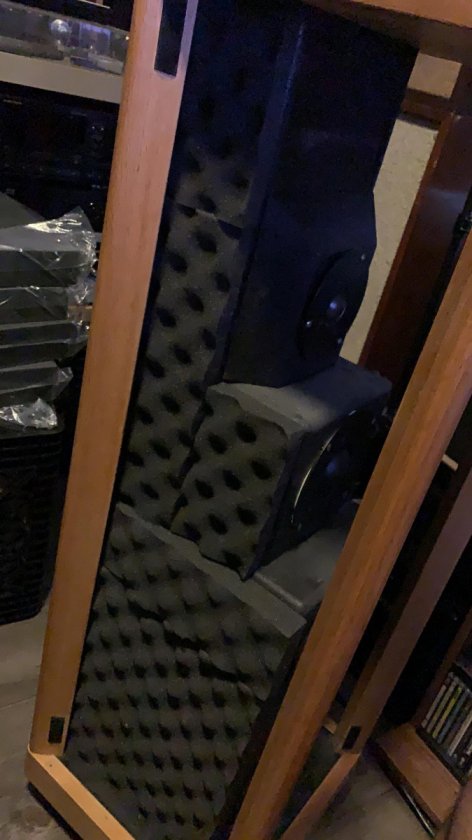

Old picture when I first got them:
Foam replaced:
