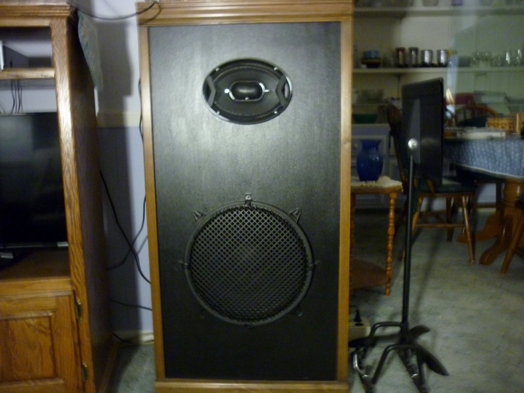

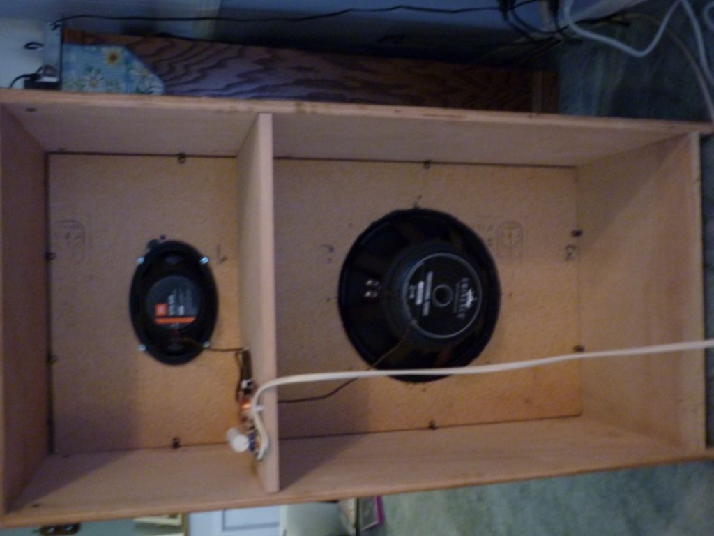

Richard, the 15 inch driver is an "Eminence Delta Pro 15" It has several things working for it. The accordion framework that attaches the speaker cone is not paper but is a special treated cloth that gives excellent moving ability to the cone. It does take a breaking in period. The 15 inch driver has an 80 ounce (5lb) magnet. It does not take much current to motivate this speaker. The midrange-tweeter combo is a "JBL-GTO 939" It does an excellent job. Musicians convinced me that the 15 inch driver  does very well at reproducing both bass and midrange. This 15 inch driver is good from 40 HZ to 4200HZ, thus my crossover network is set at 4000 HZ.
see more attached pictures.
Chuck

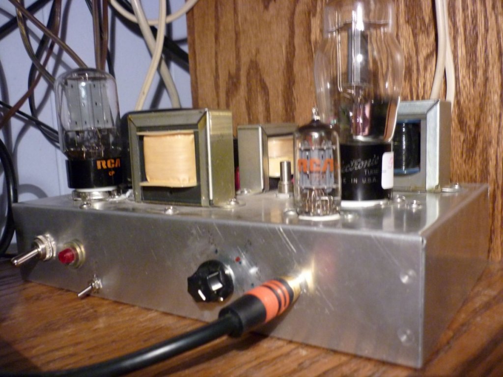

Important point for all on these SET tube amps. They should be given a warm up time without high voltage B+. Why? If one has a very low resistance rectifier tube like a 5AR4 or a solid state rectifier allowing B+ very quickly it causes cathode stripping of electrons of the tubes before the tubes are in control. On my amps I have put a switch between the center tap of the high voltage winding to ground. Given a period of time for the tubes to warm up, then I close that switch to turn on the B+. You will save a lot of life of your tubes.
See another picture of the front of one of my mono block amps. You will see two switches, the big one is AC power on and off, the small micro switch is the on and off of the B+.
To shut down your amps turn off the B+ first then your AC power. See pix.
Chuck

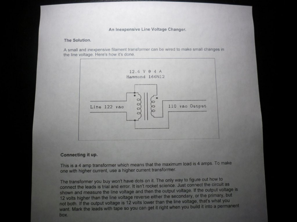

I also have a long background in working on tube amps and tube radios. It is not just the filament voltage that we are talking about. If we connect an old antique tube radio to high line voltages of today we are asking for trouble. My line voltage runs between 122 and 124 volts AC. When an old tube radio is connected to that,
 not only will the filament voltage be too high, think of the high voltage winding. If the radio had been run on 110 volts before with 250 or 300 VDC on the plates of some tubes, think what it would be with a line voltage of 122 to 124 AC.
Note a picture of an easy fix for these old antique radios which I found on Anglefire website
Chuck
