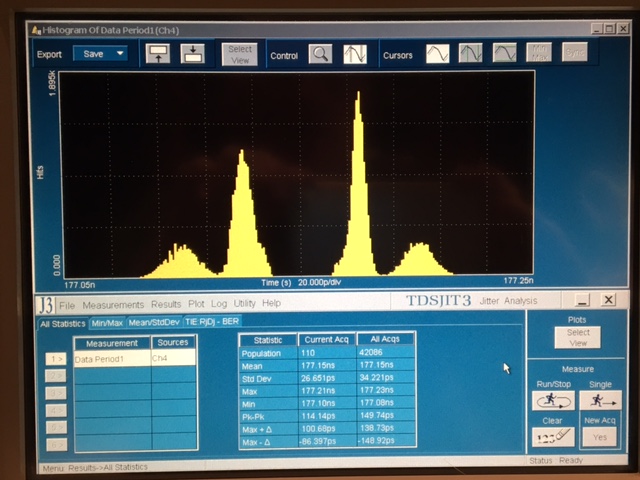

So, I selected a music track that has a lot of dynamics in it and I took samples during the duration of that track.  Then I stopped the sampling and generated the plots.  This is a distribution of real time intervals, around 42K samples over 5 minutes.
Digi HAT jitter distribution, 20psec per division:
Interchange jitter distribution, 10psec per division:
The Interchange has about 10psec of jitter and the Digi Hat board 60-70psec of jitter.  This proves to me that the current method of measuring jitter is insufficient and misleading.  The sound quality of the Digi HAT is great for a $150 system, but their jitter claims are somehow wrong.  I don't believe it's their fault.  They are using a flawed measurement method that everyone else uses.
My Interchange is more musical to me, and I think I know why from these plots.  This is the correlation between jitter and sound quality that I have strived for.  I think I have something here.  I may have to share this method with John Atkinson.  It's time we had a decent correlation.

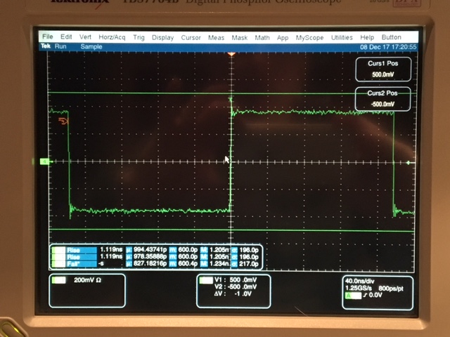

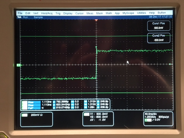

Here are the S/PDIF signals, first the Digi HAT:
And the Interchange:
The rise and fall times for the two devices are almost identical, around 1.11nsec, but my Interchange has the same risetime with less voltage swing.  The Interchange has a swing of .5V P-P like the spec requires and the Digi Hat board is more like .75V P-P.

enlighten me regarding the deviation for each unit.  Seems one order of magnitude less for your renderer.

The standard deviation for the Interchange is about 20psec.  The Digi HAT is difficult to measure.  If you include all of the humps, it is 100-120 psec.

in the measurements of the spdif output squares,
the flat pieces appear to be overlayed by noise — not ringing.
This is the case both for the digione and the interchange
measurements.
What is thw source of that noise?

It measures the period of a repetitive signal tens of thousands of times.  With S/PDIF it locks onto the shorter of the periods since the signal has a changing period.

The opening post of this thread shows four screen shots. I'm referring to screen shots 3 and 4
that show square waves in them. What is causing the noise on the flat part of the squares?
Okay, this small overshoot and ringing on the square-waves is because of the ultra-fast rise-times.  It settles out quickly, so not a problem.  This small ringing has no effect on the jitter.  In past lives, I usually optimized transmission-lines by allowing a small amount of overshoot and ring.  This produces better performance.
The small noise riding on the rest of the waveform is typical in digital systems.  It's thermal noise, power supply noise and ground-plane noise.  The reason you are even seeing it is that the B/W of the scope is 7GHz.  Most scopes will show a flat-line, but it's not real.  There is always a little noise riding on the waveform.
