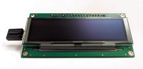

It's been a long time in coming but here is an overview of the new OLED graphical display that will ship with our preamps starting later in May.
The video can be found here:  https://youtu.be/TWll71OEVM4
In the video the display is shown through a light gray acrylic lens that replace the dark gray lens currently used with our preamps with our existing 7-segment displays. The scrolling lines and such are artifacts of the phone's video camera. The OLED display is quite clear, bright and steady.

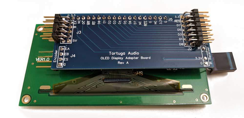

« Reply #23 on: 9 May 2018, 10:47 am »
Hi Morten! The OLED display looks fabulous :) Very informational compared to today - good work!
As I have my Tortuga in a cupboard (and would like to keep it there), I plan to get an OLED display and mount it in a frame under the cupboard, which is hanging on the wall.
To do that, I would need a longer ribbon cable from the Tortuga to the display, say around a foot long.
  • Would the additional length cause any issues?
  • Could the infrared sensor stay in the Tortuga, or does it need to be in the OLED display assembly
Finally, any idea what the OLED display price will be yet?

« Reply #24 on: 9 May 2018, 02:25 pm »
Jens
While I'm not sure on the practical limits of cable length but I'm quite confident 1 foot cables would be no issue since I've already been using cables that long with prototypes/testing. The OLED data cable uses parallel communication (8 bits sent simultaneousy) so it's both very fast and far less susceptible to noise etc. compared to a serial data cable of comparable data speed.
The OLED display proper is mated to a Tortuga Audio OLED adapter/interface board. The adapter board has:  1) a 2x7 pin header for the parallel OLED display/power ribbon cable;  2) a 2x5 pin header for the IR/Encoder ribbon cable;  3) 1x4 pin header for interfacing the Encoder via its cable, and; 4) a 3 pin solder socket for attaching the IR receiver module.
You could connect the Encoder and IR Receiver directly to the V25 board and not to the OLED Adapter Board which would eliminate the secondary 2x5 pin ribbon cable to the OLED but it's usually more convenient to to interface these to the OLED Board.
OLED display pricing is still being finalized but is expected to come out somewhere between $100-200 including adapter board (already attached), both ribbon cables, and IR Receiver. I hope to have that finalized within the next few days.
Cheers,  :thumb:

« Reply #26 on: 10 May 2018, 06:19 pm »
Morten,
Which display will have the largest volume readout in size? The OLED display is very nice, but will the digits be larger than the pair of numbers in the standard display?
Here you can see the 2 displays side by side (OLED is on and the 7-seg is off). The OLED screen is 0.85 by 3.2 inches whereas the fixed height 7 segment display numbers are only 0.57 inches tall. I'm using a large 48 point font for the volume display numerals which is just a tad bit larger than the 7 segment in height. The OLED also uses 3 other smaller fonts for other text/numbers.
The volume display number font size could be further increased but doing so would crowd out the volume bar and most other info. I'll wait and see how people react to the OLED display using this font size before changing anything.
When placed behind a gray acrylic lens the 7 segment is easier to see because it can burn brighter but the OLED is an overall better display for interacting with the remote control and in normal lighting situations is quite visible from a typical listening positioning.

The new OLED Display Module is now available for purchase by the DIY community. Over the next few days we'll also be announcing an upgrade program for owners of existing V2/V25 versions of Tortuga Audio preamps.
The OLED Display Module is a 256 x 64 pixcel white graphic OLED (Organic Light Emitting Diode) display for use with Tortuga Audio's LDR.V25 ("V25") LDR preamp controller board including all V25 versions of Tortuga Audio preamps including kits.
The price for the OLED Display Module including control cables, installed IR receiver module and V25/OLED enable jumper is $149. Encoder with cable is optional since most existing owners of Tortuga Audio V25 preamps already have an encoder. We currently have over 90 units in stock.
The link to purchase the OLED display is here:  https://www.tortugaaudio.com/products/diy-preamp-components/oled-display-module/
The OLED display product  page on our website is still quite spartan. We'll be adding more information over the next several days. Here are some pics.

We've gone around the track several times on how best to approach this but after numerous prototypes we concluded that the right way to incorporate the new OLED display into both existing and new preamps is to:
1) machine a new pocket on the back side of the existing front panels
2) expoxy the new display in place into that pocket using a small amount of epoxy glue in each of the 4 corners of the main OLED board
3) remove and replace the existing dark acrylic front panel inlay with a less dark acrylic front panel inlay for better visibility
4) re-orient the IR receiver module attached to the OLED display into a vertical position in order to get clear view into room
5) add the OLED enabling jumper to the V25 board
6) load the OLED enabling firmware into the V25 board
7) add the new 2x7 OLED control cable
8 ) if required, replace the shorter existing 2x5 display cable with a longer version
9) attach the existing encoder control cable to the OLED display adapter board
10) remove and discard the existing display mounting board (existing preamps)
Given the above steps, the only practical way to handle upgrading existing V25 based preamps (or upgrading V2 to V25) with an OLED display is to ship the unit here and have us do the conversion work. We'll be adding that as an upgrade service soon.
