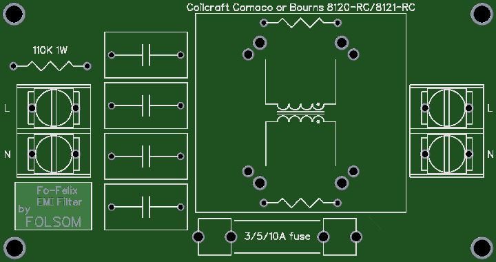

FO-Felix in the house by MttBsh
https://www.audiocircle.com/index.php?PHPSESSID=adc7vbp9cbqehppjmfba10l3o5&topic=161544.0
...Once installed, it took a few days for me to really begin to hear improvements, but now, a week in, those improvements have gone from subtle to transformative. The best word I can think of to describe the sound I'm getting now is "effortless". Any trace of stridency, boominess or glare that was present is gone. The sound is more clear, wide open and "fuller", with uncanny 3D depth and the deepest bass I've ever heard, low level details are floating in the air. These are exactly the kinds of improvements I had hoped good power conditioning could provide, but it's much more than I expected...
One of the main bottlenecks of our audio systems is the quality of the electricity supply that we suffer. In the real world we have to live with the imperfections but we can try to minimize them, spending as little as possible for it, using technical / professional solutions.

Removing the load-side shunt capacitors (as supposed in the Fo-Felix version of the filter) will give us a smoother frequency response but the corner frequency is shifted to the higher frequencies approx. 25 times
CMF without load-side shunt capacitor
