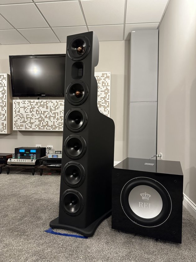

Here's my NX-Otica build thread with lots of photos.  I'm in the Chicagoland area if anyone is interested in taking a listen  8)
https://www.audiocircle.com/index.php?topic=184521.0

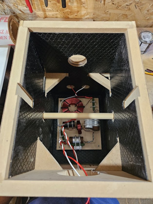

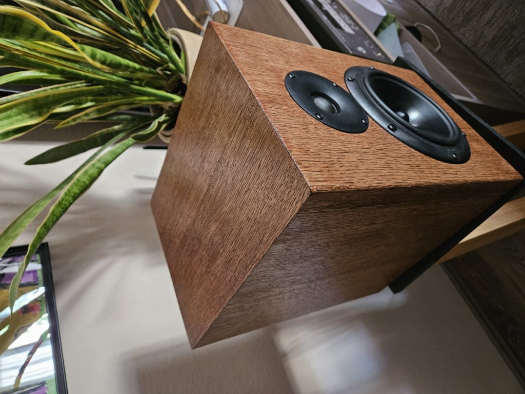

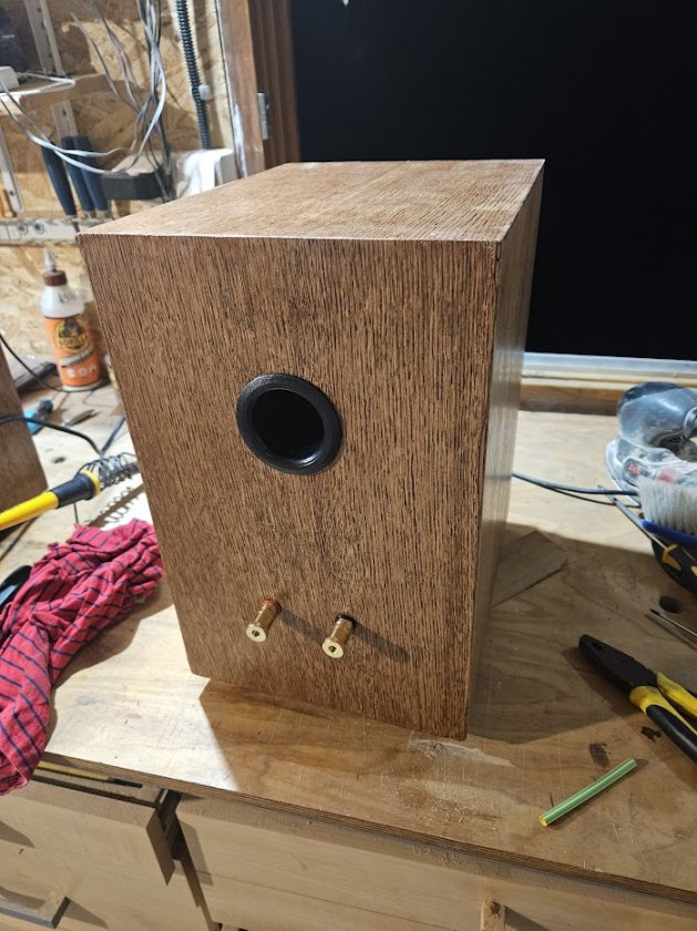

Hello All,
Here is the lastest build from far-far Hungary/Europe!
I love every seconds of this build. Sound amazing!
here is the process and a result:
