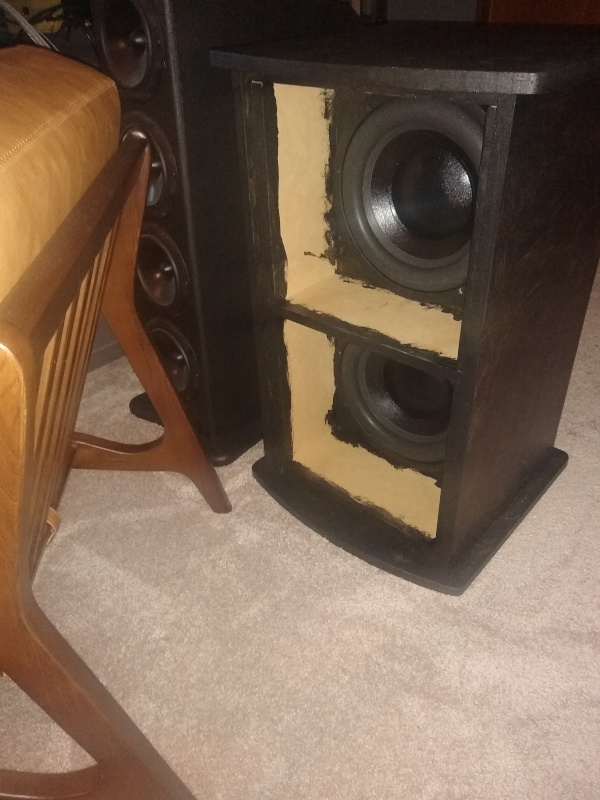

I finally started making ground with my Encore builds for my kiddos.  I enjoy to attempt new methods so I used car paint.  I used a vinyl sealer to attempt to seal the MDF edges but I was mostly unsuccessful.  I'm going to paint the edges black to cover the edges.  The other challenge I had was trying to connect the internal wire to the binding posts.  I finally decided to take the binding posts apart so I can lay the binding post panel flat and was able to get a solid connection.  Not yet done but here is the build so far.
Bestway to seal the MDF edges is the use "wood hardener". Needs a couple coats. Then sand smooth. Also protects the edges from dents.

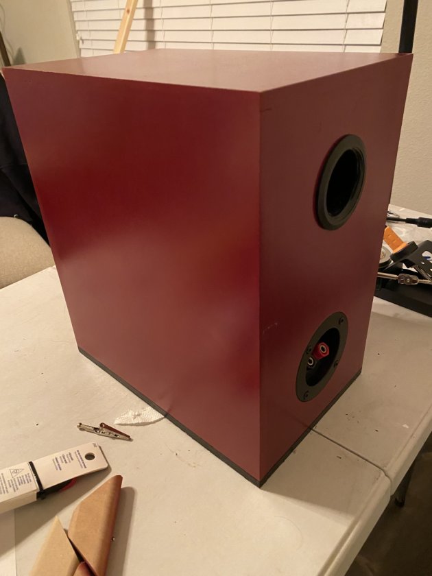

Hi there! Not sure if this is the best way to start my activities on the forum, so please, fell free to guide me accordingly.
I am a long time follower of Peter Rawlings youtube content, always impressed with the quality of his work. Hope to reach out and contact him in due course. Need help with cabinet damage and black piano finish repair of one of my speakers.
I am located in Austin, Texas.
Any guidance would be very much appreciated.
