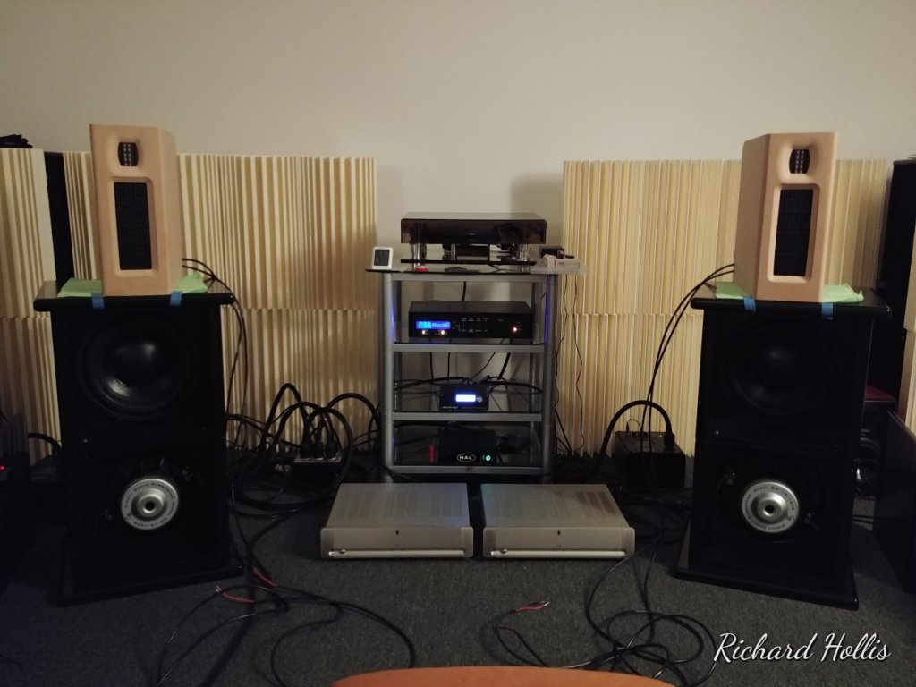

One advantage of having a dspMusik crossover is that with speakers like The Monoliths, you can place the planar tops and servo subs in different positions in the room and use time delay to adjust for the distance offsets.
This way if you get better bass response with the subs in different positions than the planar mains, it can be compensated.

Experimenting with The Monoliths and separating the planar baffle from the subs.
Put the subs back 3' from the rear wall and moved the planar tops on stands closer to the listening position.  I am setup in my larger listening room, so using 1/2 of the 6x12's (3x12) with the HX300-12OB servo amps.
The dspMusik 2x8 is being used to compensate for both the distance offset and SPL drop from the subs since the two pieces are in different locations in the listening room.
