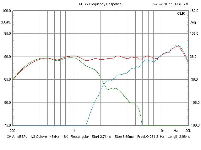

Here's  response Danny  measured in the new baffle.
jay
HAL
Re: The Monolith open baffle planar speakers
« Reply #121 on: 30 Jul 2018, 09:18 pm »
Jay,
The frequency response from Danny looks great!
Prototype dspMusikLCD digital XO is in work to bi-amp the planar speakers with the HX300 servo amps for the subs.   The original crossover I did for the early planar prototypes is very close.  Now to tweak it a bit.

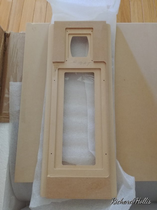

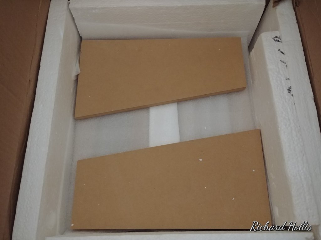

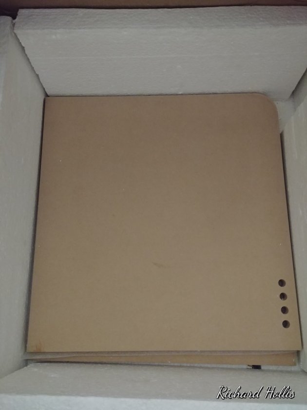

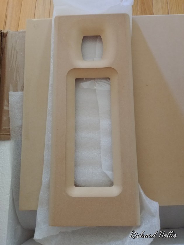

IT... BEGINS...
The Monoliths flat pack baffles have arrived and Danny and Jay's team did a great job.  Packed to survive!
Now to see if I can do justice to them in glue-up and updated dspMusikLCD crossover.

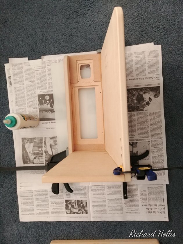

You'll do fine gluing them up  Rich,  just have a damp Q-tip handy to wipe  any glue squish out of those  nice reveals I cut  for you.  You won't need much clamping   force for these,  just enough to keep things    snug while the  glue  sets off.

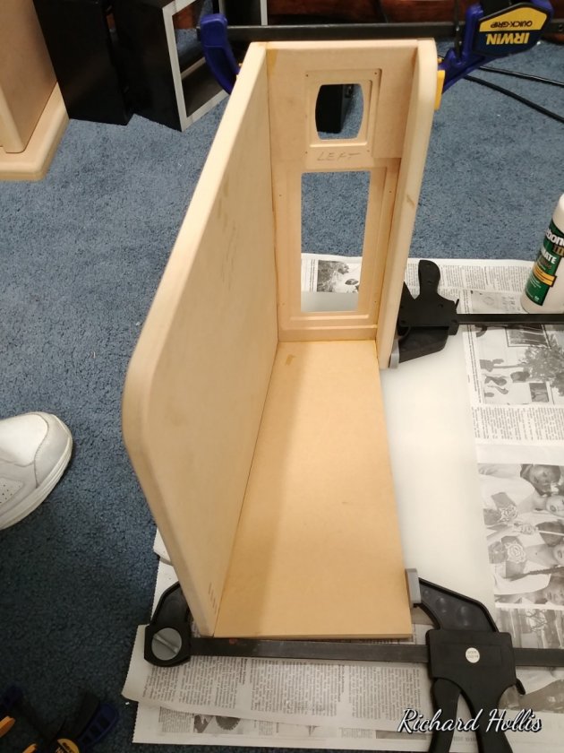

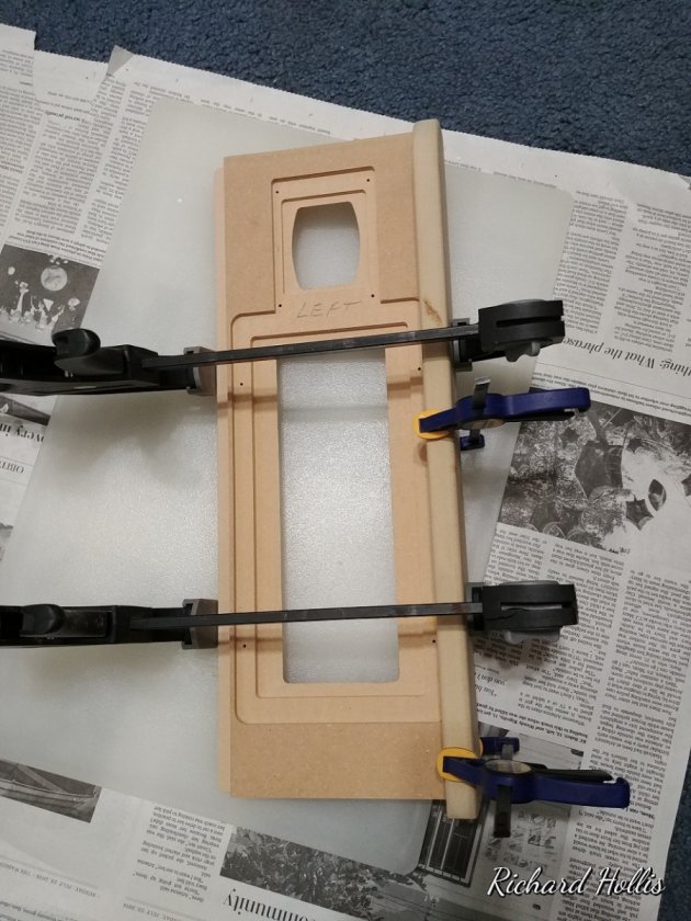

Glue-up has begun.
Started with the short side wing and small clamps.  Glue and let set.

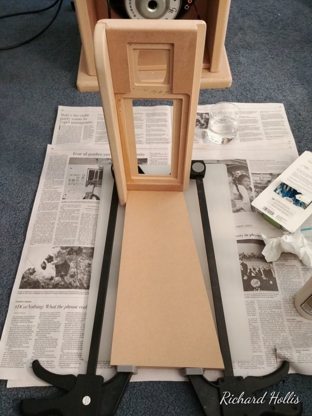

Attach bottom plate to baffle and short side wing with glue and clamp let it set.
After that will attach the long side wing with glue and let it set over night.
HAL
« Reply #126 on: 31 Aug 2018, 10:28 pm »
Baffle #1 is glued and drying. Will let it set overnight and glue baffle #2.

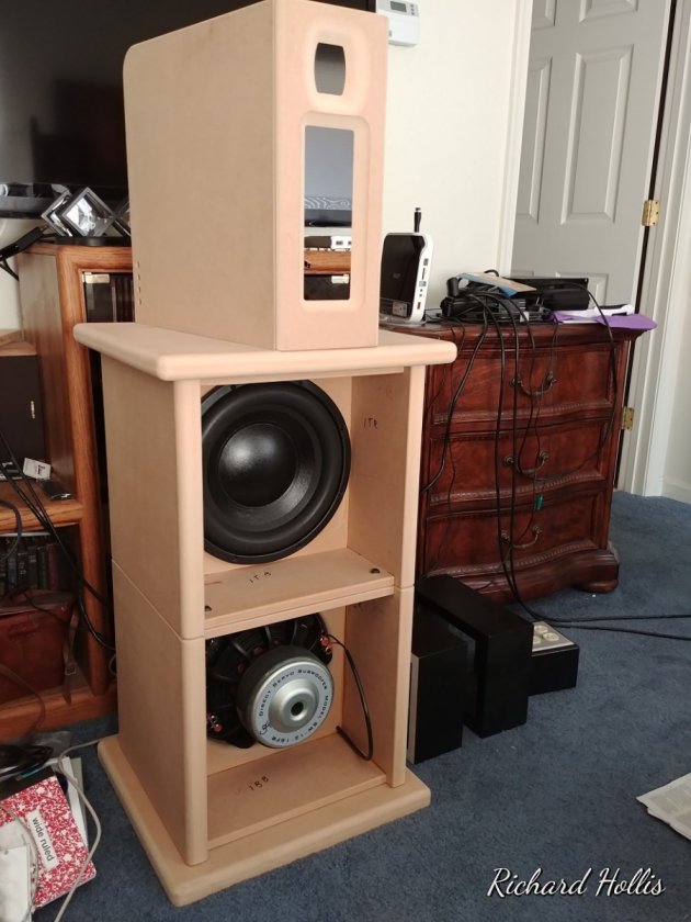

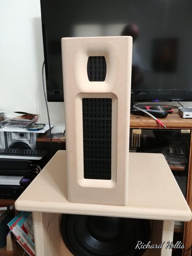

First look at the new planar baffle on the 2x12" servo sub base.
Once the second baffle glue dries tomorrow, will install the drivers.
HAL

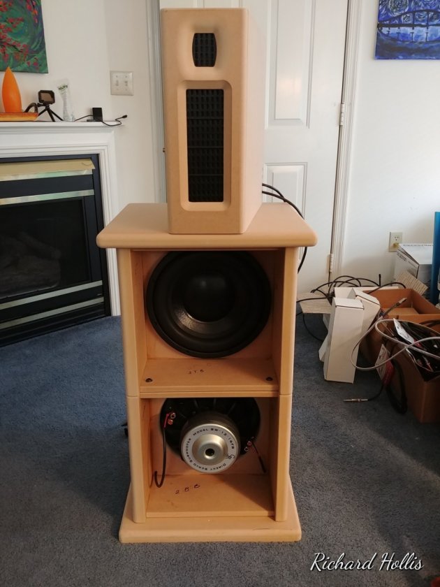

Baffle #2 has planar drivers installed and wired for testing.
Full front view of The Monoliths.

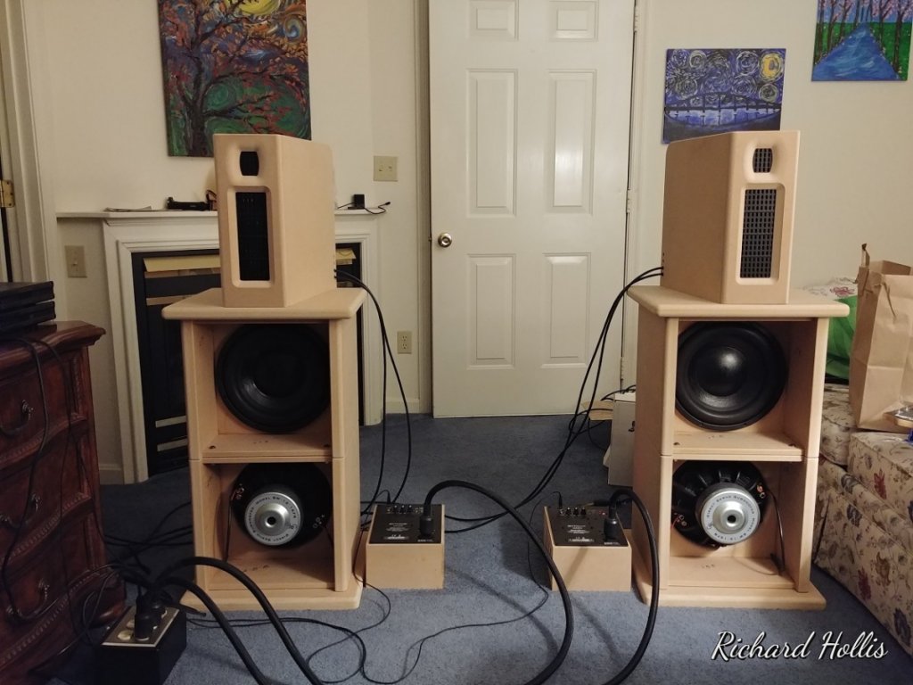

Stereo setup of The Monoliths ready for some listening trials with the first version of the dspMusikLCD 2x8 digital crossover.
Have adjusted the time delay for the servo subs to match the planars distance offset.

First listening sessions with tweaking in the dspMusikLCD crossover and it is sounding very good.   Some of the ideas from tweaking this may do good things for the line array as well!
Planars and servo subs are definitely my thing.

Got to use a very large room for measuring The Monoliths planar open baffle and from those did the updated digital crossover design.
Now that I have the updated speaker dspMusikLCD digital crossover design running it sounds even better than the first version.  Running the planars with a pair of Parasound ZAmp v.3's and the Rythmik HX300's for the subs.  They play cleanly and plenty loud in a living room that I have them in that is more normal size.  Put some PI Audio Group diffusor panels behind them and helps tame the room a lot.
Just when you want to sit down and do more listening, time to disassemble the speakers.  The two 2x12's go tomorrow for finish application.
