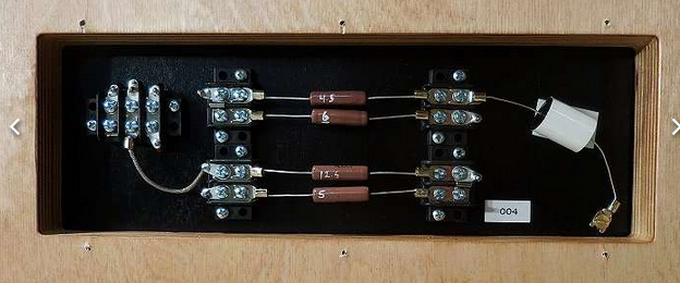

I'm hoping it's a good thing because it's forcing me to do it myself.
I'm not sure about your DIY enthusiasm but I would advise that you stay flexible and experiment. Some of that flexibility includes:
low end bass management- I found it best not to ask too much of your woofers. They are covering a lot of bandwidth and to try to get them down to or  below 40 or 50 hz is a bit aggressive. But maybe Danny can do it. I ended up using sub-woofers and a Berhinger processor to equalize and cover 80hz and less. I am using Infinite Baffle that are actually time aligned w the main drivers. it load the room like a dream and can't live w/out them now. The ultimate would be to use Danny's open baffle subs... maybe some day.
The attenuation between the woofer and the CD and the woofer: My crossover allows for the swapping of resisters in the shunt and series position. You will need to flexibility here to match the room it's in. I have added a picture of cool way to do the resisters (Credit- Volti Audio).  You may also want to ask Danny to build an attenuating network to eak out the last bit on the highest end. The CD is waay more efficient than the woofer, so, you have some room to play w here. This will go a long way to customizing this speaker to your room and ultimately the music you listen to. The CD and horn is a powerful wild animal that needs to be tamed to your domestic environment. I'm not familiar with the 811, so, I can't help you there except I know it has some problems that needs to be addressed.
Stuffing- When people tell you to do this or that, don't believe them. You will have to experiment yourself. Don't be in a hurry here. Live w something for a month or two then make a change. If you want to hurry the process, find a  good mono reference recording and do one speaker and listen to the difference. Same with ports and bracing. Changing bracing and ports sounds daunting but I can describe how to do it easily.
Crossover Components It is my opinion (and probably not Danny's) that old school PIO caps are the way to go in certain positions in the crossover. This subject really deserves it's own thread so I'll be brief here... Just make sure that you tell Danny to allow room for some BIG caps. I would recommend trying some cheapo Russian caps from Ebay. From there it gets a little exotic (trying to find them but not necessarily  in price compared to Duelands etc..).
