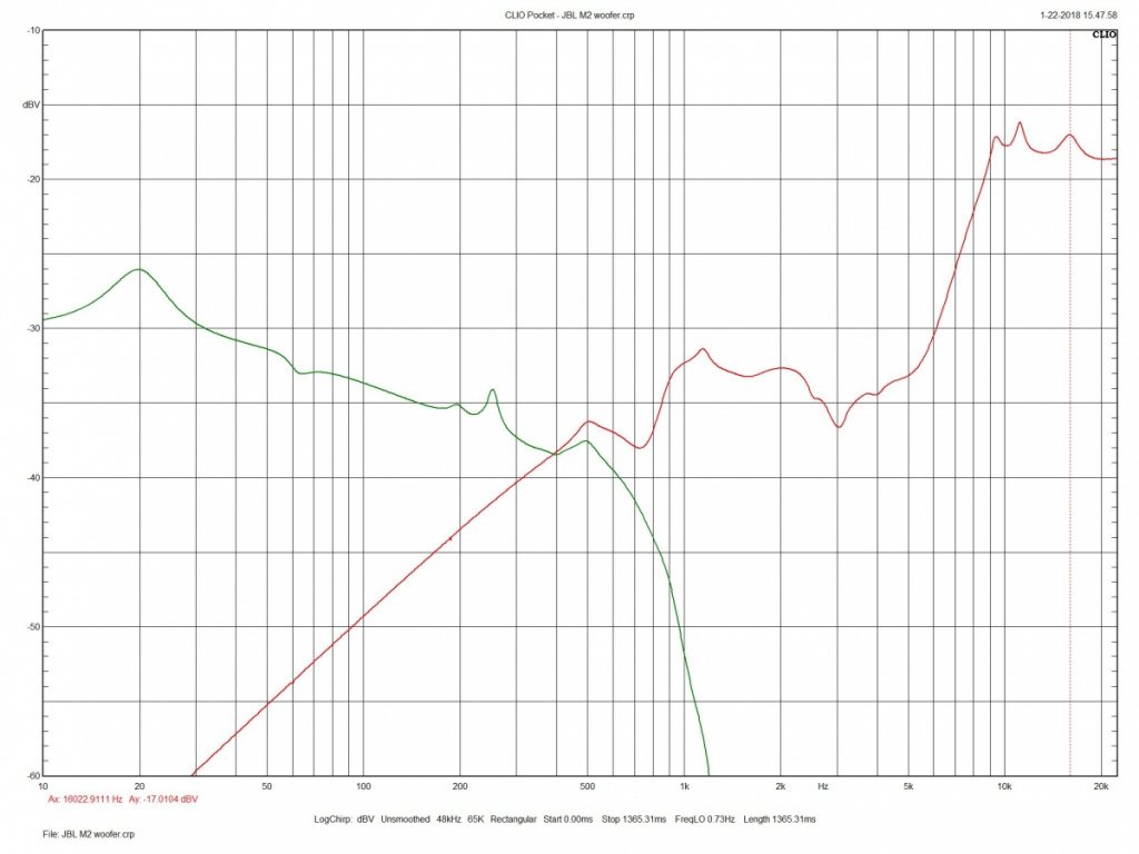

Have a request for a dspMusikLCD digital crossover for the JBL M2 speaker system to use instead of the Crown amps the original crossover was created to run.  This will be for a demo once the system is setup.
Have the prototype block diagram completed and running. Next will be testing the response to see if this matches the reference curves.  Will setup Pocket CLIO for taking the response data.

Have another person interested in the JBL M2 digital crossover, so will get the dspMusikLCD unit programmed for response testing as a comparison to the reference frequency response plot in the document.
Will post them both as a comparison once completed.
HAL
Re: dspMusikLCD crossover for JBL M2 speakers
« Reply #19 on: 22 Jan 2018, 09:03 pm »
Here is the results of the dspMusikLCD 2x8 digital version of the JBL M2 digital crossover from the reference document posted earlier with the frequency response plots.
Problem is the scales on the original response graphs are missing in the PDF, so no absolute reference other than the data in the document.
Looks close from what data I can check.  Now for someone with JBL M2's to check the sound.
