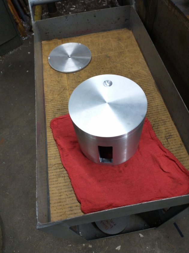

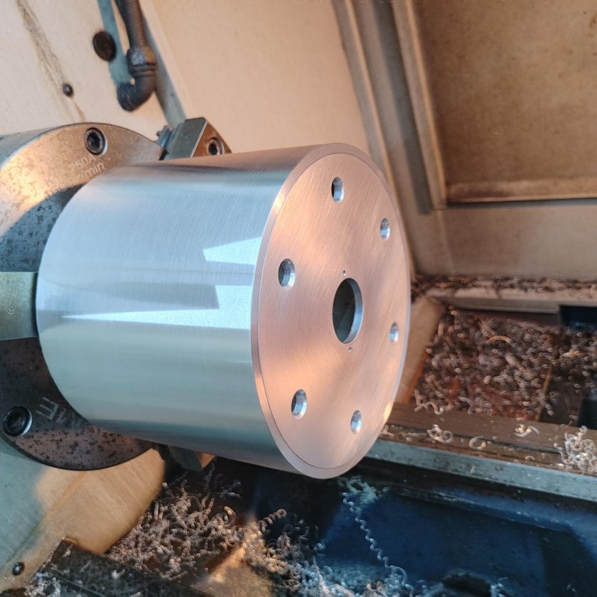

Case is machined and waiting on CNC lathe again for dial completion. I really like how the whole case acts as a heat sink....

Thanks gents. I have been wanting to design an amp case like this for awhile for aesthetics and function. I really like the sound of this Class D amp and it deserves a custom case.
The design goal is to have all hardware/fasteners hidden with a minimalist appearance and have ability to swap in different amp board later if I want....
I was running it 3/4 volume throttle on the shop speakers all weekend and it never skipped a beat. I could feel the warmer air circulating through lower vent holes by simple convection. Don't even need a fan running in this unit...

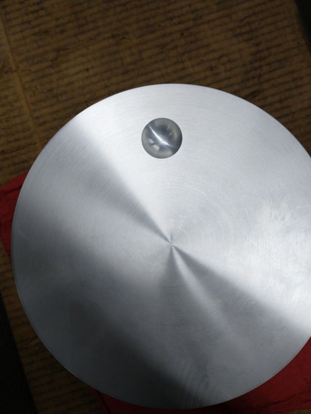

Fine tuning the dial interface/fitment. A couple thousandths each side is the key to smooth-as-butter operation :)

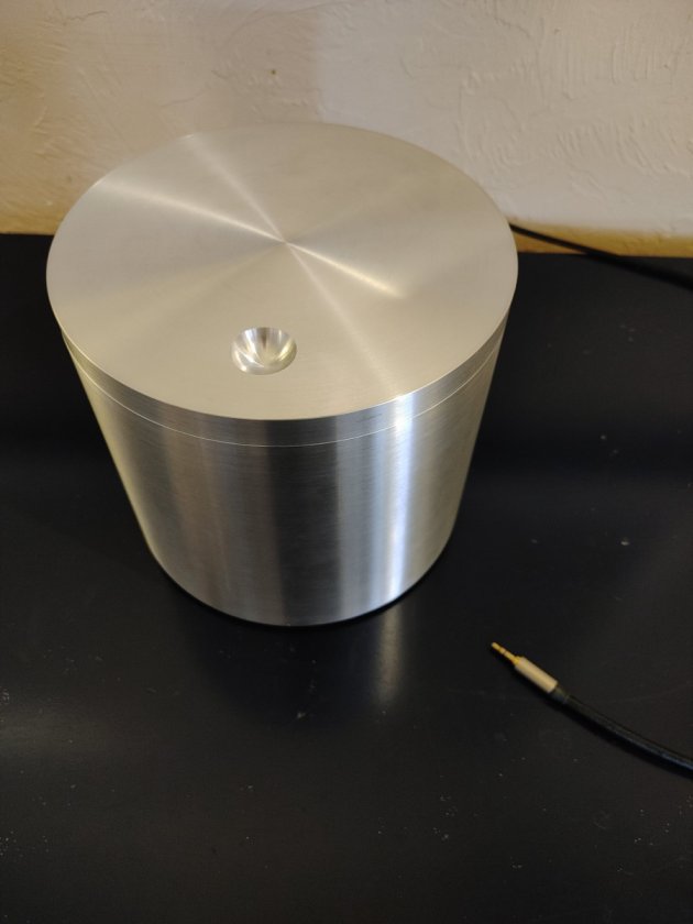

« Reply #115 on: 5 Jan 2024, 08:15 pm »
Been running the XS-8TL's with this amp for better part of the last week with my phone DAC and FLAC files.
Barely gets warm running them half volume on the dial.
I took the dial back off and reset it to 6'oclock being zero.
WAF is at 100% too as opposed to the amp and CD player in the living room.

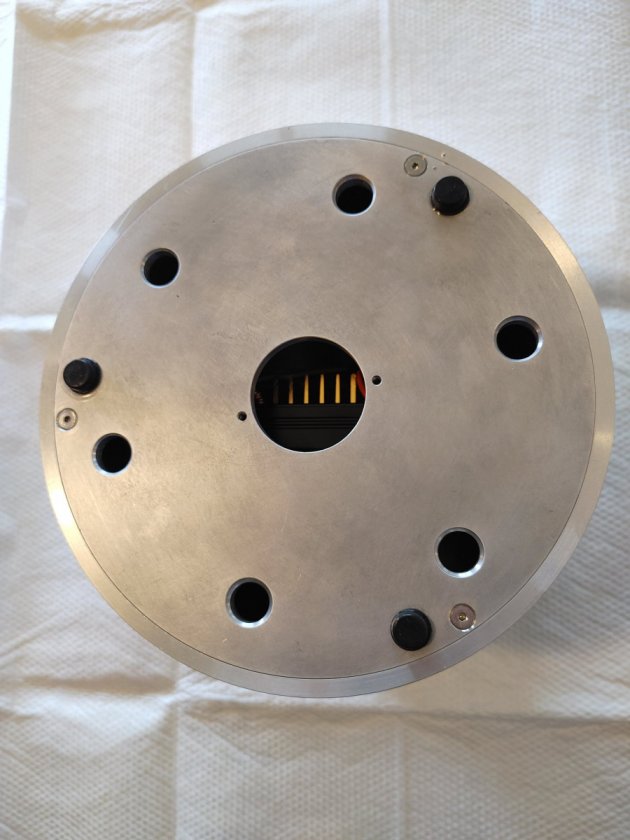

Here's a pic where I removed the fan so you can see direct airflow path to heatsink radiator.
I also added 3/8" height rubber feet
« Last Edit: 6 Jan 2024, 04:07 pm by xschop »

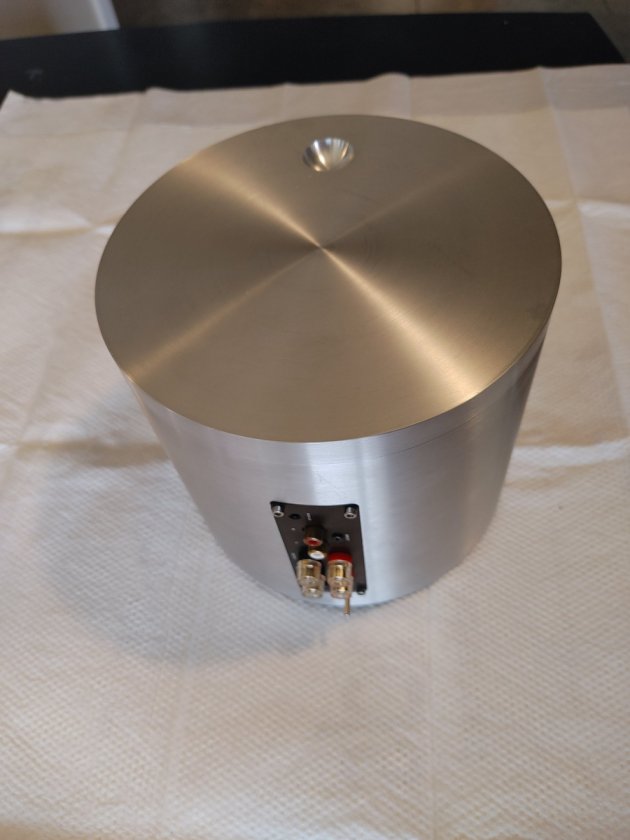

« Reply #118 on: 6 Jan 2024, 04:11 pm »

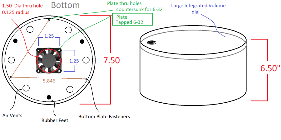

Too big.
 Here are the base dimensions...
I figured out how to upload pics here (I think). It takes up 1/4 the space that my restored Onkyo A8017 amplifier did. It sounds every bit as clear and powerful too.
