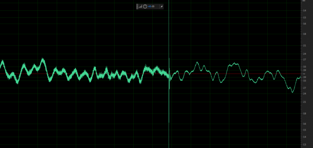

Fjendbo
  • Posts: 65
Re: NuForce MCA-20 loud hiss
« Reply #13 on: 26 Oct 2017, 06:36 pm »
Okay, I don't think a measurement really shows it so there's a link to the audio file of the measurement as well. The measurement is taken 1 cm from the tweeter.
Power ON
Power OFF
Audio file: https://www.dropbox.com/s/x1hh3y2m1is8432/Noise.mp3?dl=0
