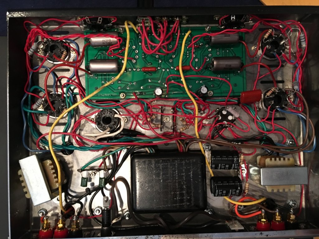

Well after 3 days of hard work (including a fulll day of debugging errors), I'm up and running! The wiring is going to get cleaned up later as I've got to sort out something when Bob sends me the parts (I undid the wire wrapping when I was debugging).
Now for some Music and that warm tube glow!

Next step is to clean up the rats nest wiring job and reapply the clear coat finish re: i marred it up before it cured while disassembling and reassembling the unit like 5 times yesterday  :weights:
I had a couple of early problems--first I mis-wired the rectifier tube which caused it to arc when i fired the unit up   :banghead: Sorted that out....then checked for bias voltage and discovered I was shorting two low-voltage wires on the driver board to chassis (pushed them in too deep from the top--  :oops:)
I then had another small issue which caused the rectifier tube to arc a second time :roll:.
Anyhow got all of this sorted out about 6PM last night. Played music for two hours, went to dinner, left the unit on and upon returning around 8PM found the unit had blown the fuse.  :(.
Sooooo this morning rechecked all of the voltages, installed a fresh rectifier tube thinking the first may have gone south after all of the punishment I meted out during the diagnostic / initial start-up runs, installed a new fuse, re-biased the tubes......So far so good. Been humming along at moderate volume for the last 90 minutes without issue.
If another fuse pops with the new rectifier tube, Bob suggested I recheck solder joints while I'm cleaning up the wiring--he thinks it is possible heat expansion can cause a poor solder connection to weaken to the point of failure...
Quite an adventure.

Well I'm cautiously optimistic it was the first rectifier tube that I punished re: the unit has been running continuously for close to 6 hours today without issue. I've been checking the bias every couple of hours as well and it seems very stable at .5 volts all around.
I've always subscribed to the belief that things don't happen randomly in electronics (or software for that matter)--all symptoms should repeat if all other parameters are equal. So if there was a soldering joint problem and heat expansion caused it to fail, it would have repeated by now.
Of course it could have been a voltage spike since we had storms here in Richmond VA last night, but I'm running the unit on a pretty heavy duty spike protector and these are 5 amp slow blow fuses, so I have to assume it was a sustained current draw that caused it to pop.
That leaves the only component that clearly had an issue, the first rectifier tube that I arc'd twice!
Of course I could be wrong :)

Thanks. He wrote me offline to explain. His concern is with cheap surge protectors that deform the AC wave form. I'm using a quality heavy duty unit from ISOBAR -- shouldn't be an issue.

So have been enjoying the unit for over a month now. Couple of issues had to sort through, including blowing up a capacitor (my bad), had the unit rewired by Bill Gratix plus fully checked out once the cap was replaced (Bill assembles them for Bob Latino).
Latest issue was intermittent low level static sound out of right channel (independent of volume control). Bill advised after determining it was not related to the output section or my source a) swap / check out the driver tubes (they were fine), b) touch up the driver tube socket joints (I did) c) resolder the input driver board components on the right side of the board as much as possible.
Dam if he wasn't right. Static noise gone since re-soldering the input driver sockets and touching up the resistors and caps on the right hand side of the board.
Now only question is very very low level hiss out of left channel. Has been there since the beginning I think. Can only tell its there if you put your ear to the speaker; no impact on listening, can't even detectable if your ear is not right up against the speaker (not impacted to volume control).
I've read other places that this is typical of tube amps, in particular with medium to high sensitivity speakers (mine are 94db)....
