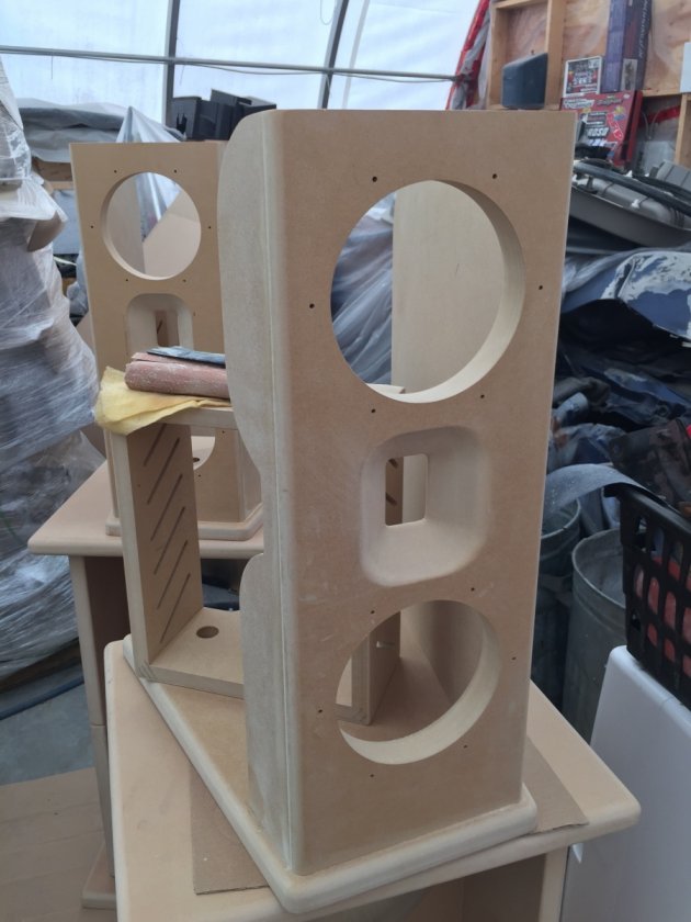

After harassing Captainhemo about saving money by building my own subs, I conceded that the modular CNC design that they've come up with is much easier to assemble, and will be a superior end product. Here's a stack of the modular subs next to the Ottica Extremes! I hope that I can hear these someday soon!

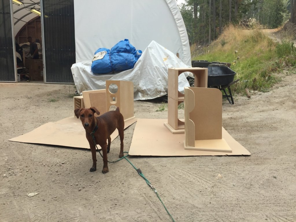

I never had any delusions about trying to cut my own waveguide, so finally pulled the trigger on the MTM's to sit on top of dual subs, so I am ready to start the build! Home we go with my flat-pack!

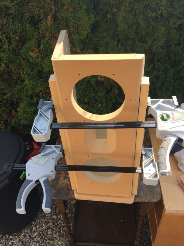

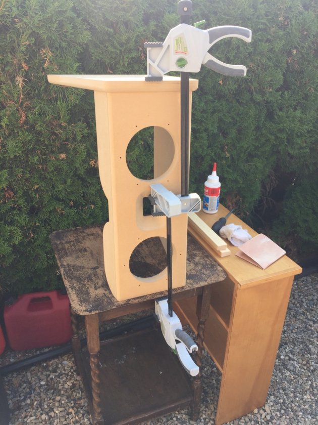

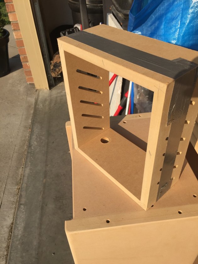

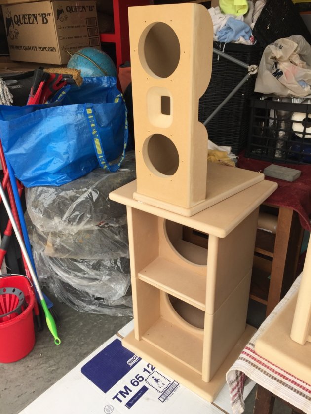

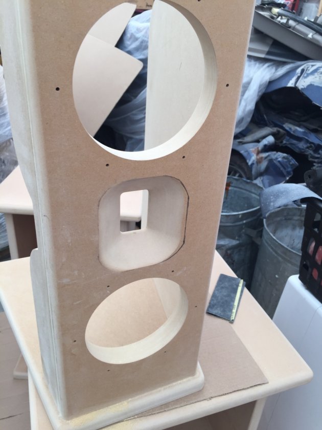

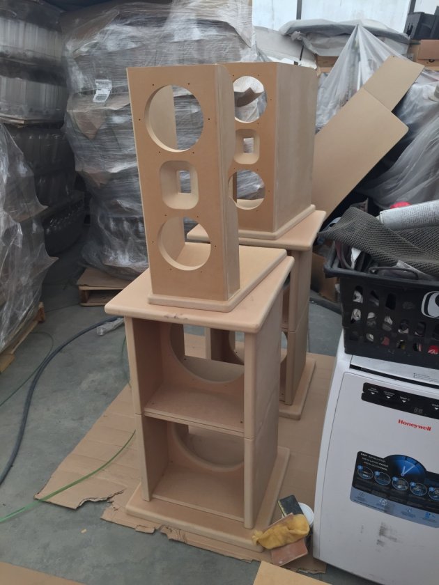

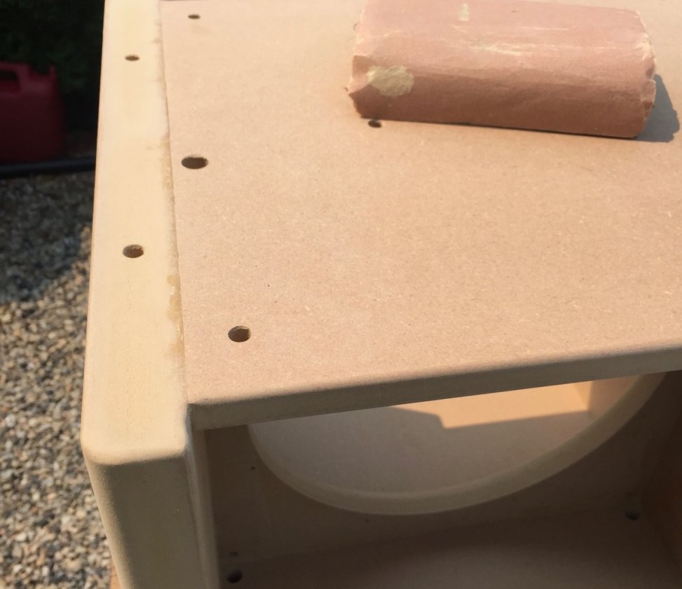

Some more assembly pics:
Angled boards to help clamp tightly
I'm not sure if you're supposed to daisy chain clamps?  :lol:

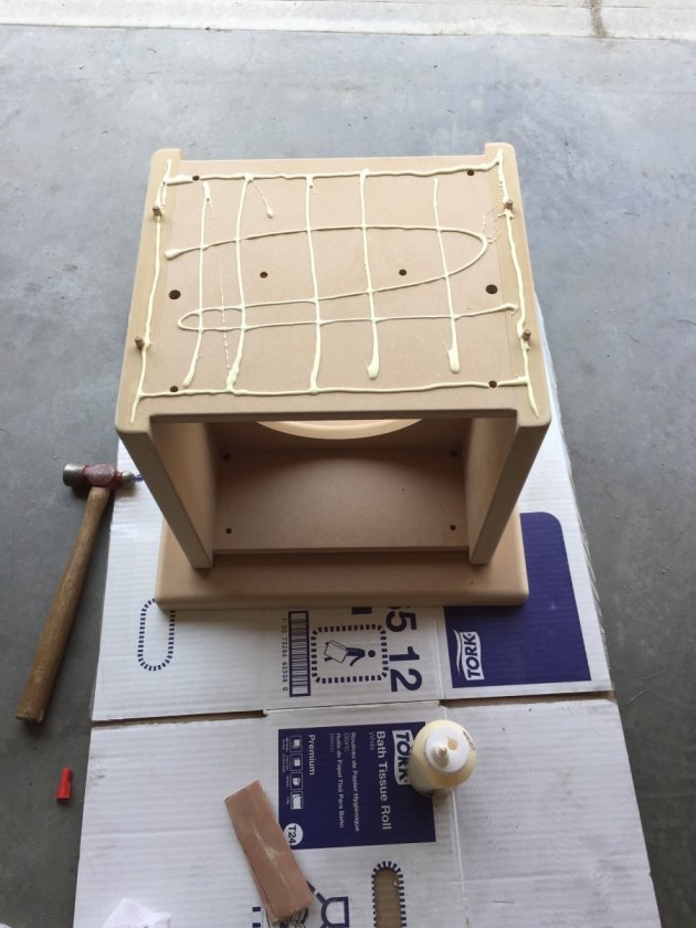

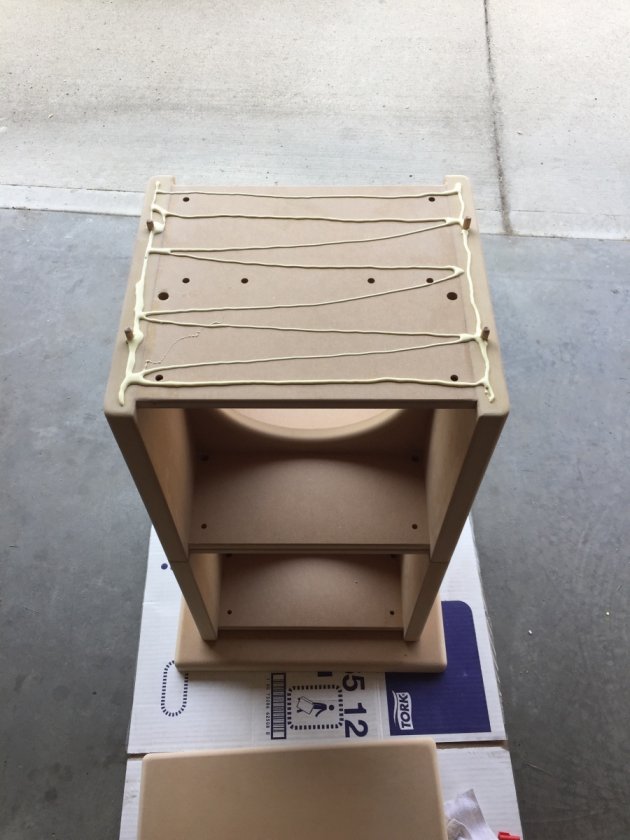

Gluing up subs

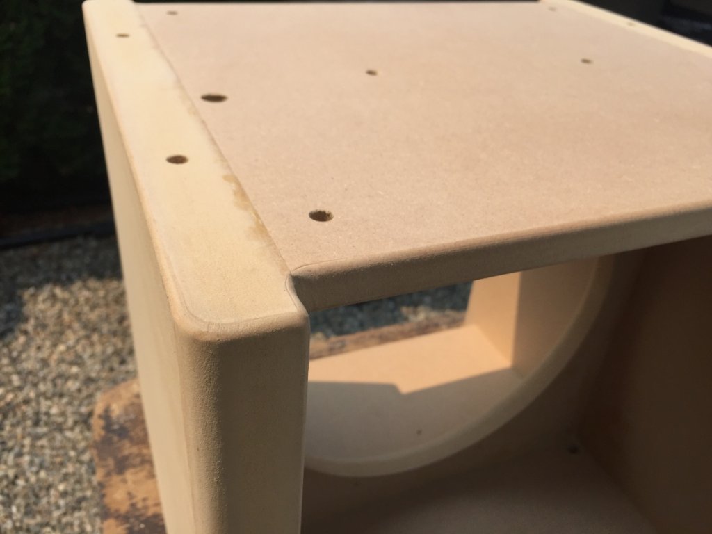

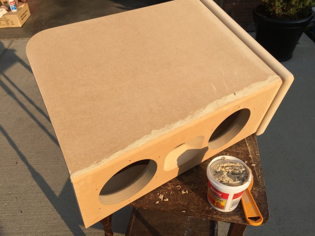

Captainhemo rounded off the tops and bottoms of all sub modules so all the pieces sort of look like they're floating on each other. I think it will look cool. Captainhemo was mad at himself for these tiny edge marks he made with the router. Perfectionist.  :roll:
Literally 5 seconds later with some 150 grit sandpaper.
Amp boxes -  on the second one, I just glued in the biscuits and wiggled it together and just let it sit.
Some filler
First sanding and assembly complete! (Excuse the messy garage - we were moving!)

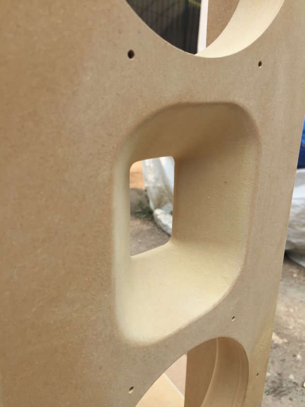

An option that Captainhemo told me about, since I'm painting these, is to slightly round off the edge of the waveguide by 3/16" on the sides, and then gradually to the top and bottom as the woofer comes right to the edge of the waveguide.
It's a bit tricky to have a consistent edge, but not too bad following the pencil line. Half way!
All done.

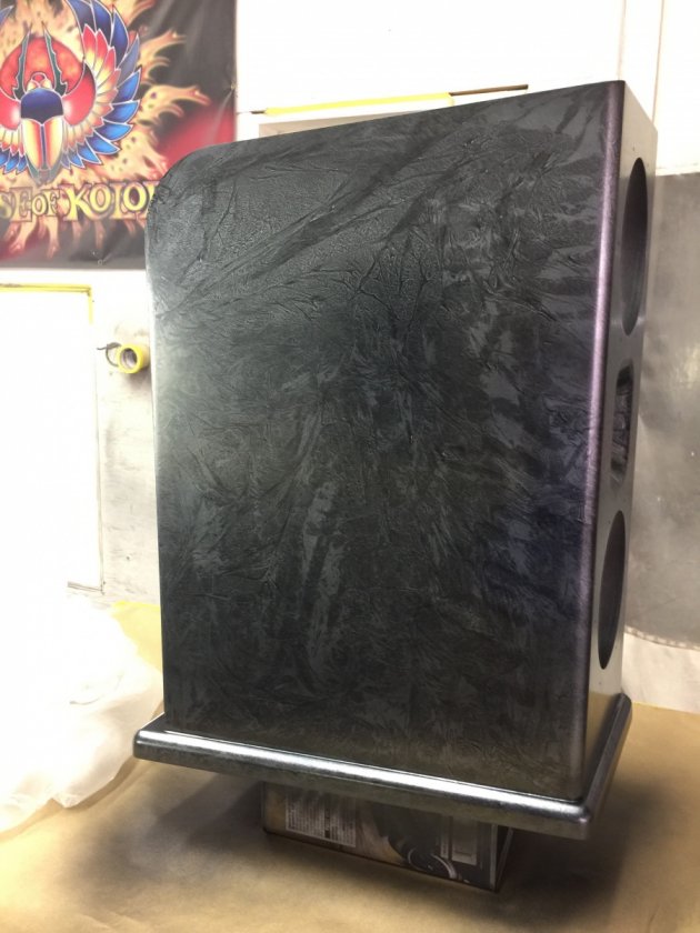

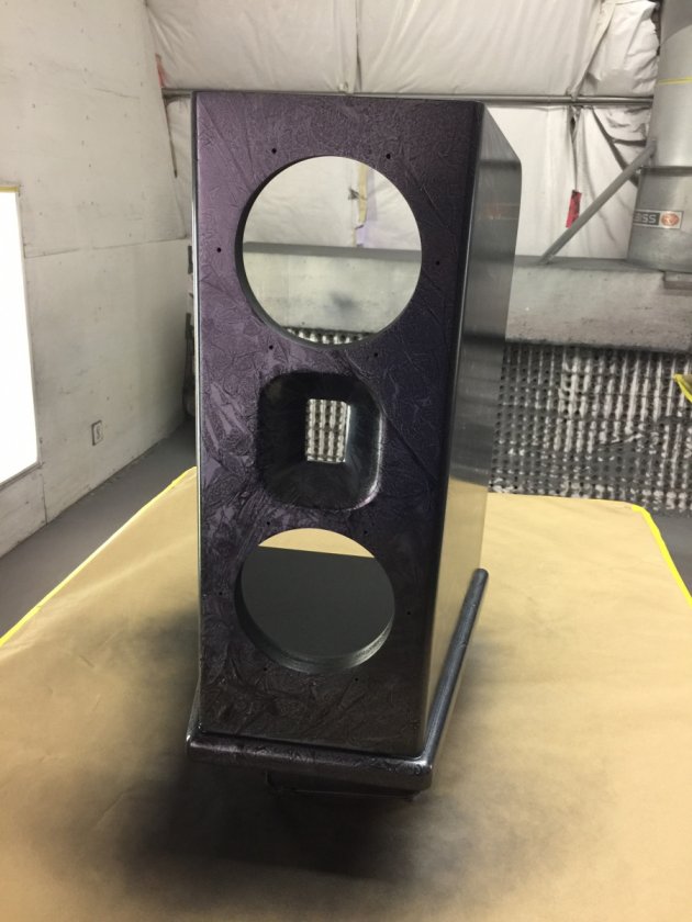

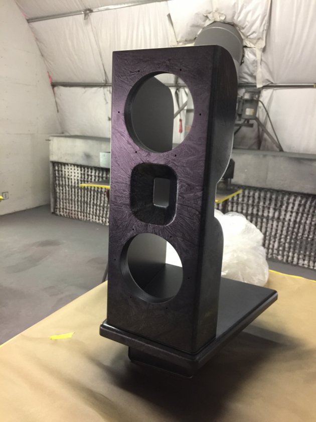

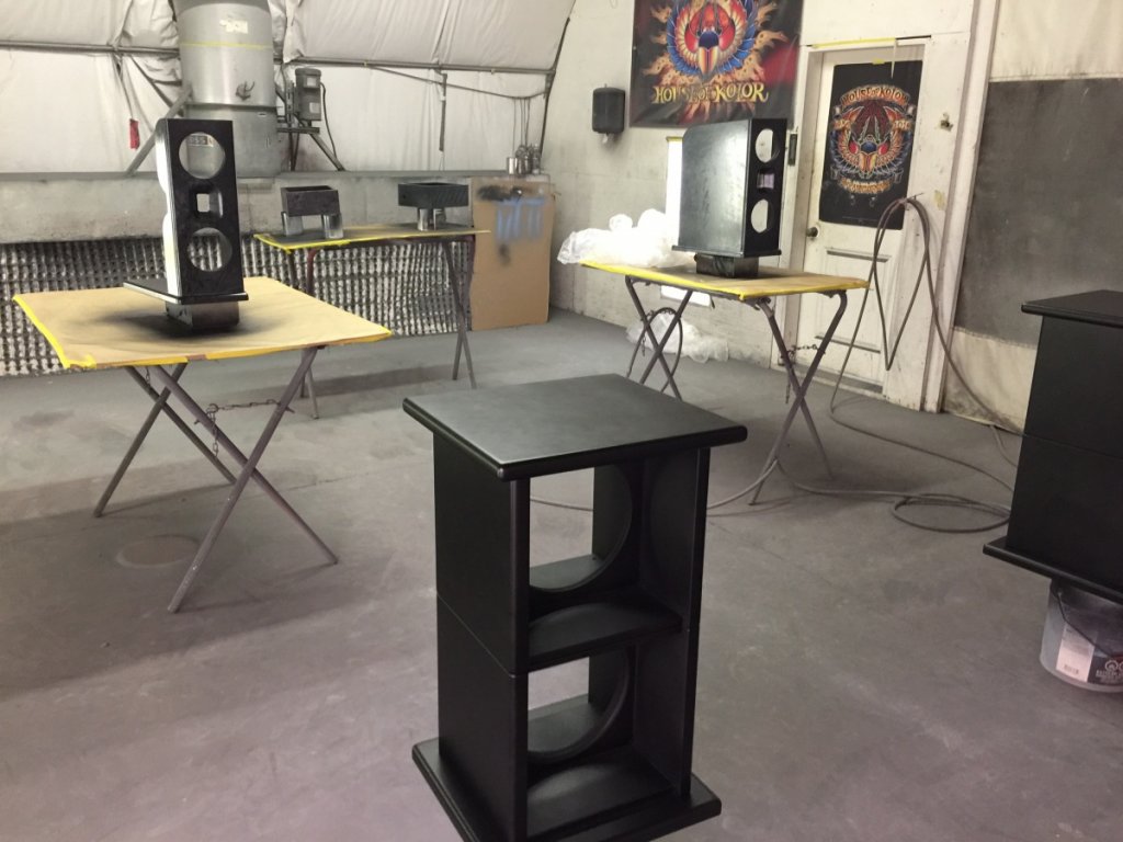

Okay guys - finally some paint pictures!

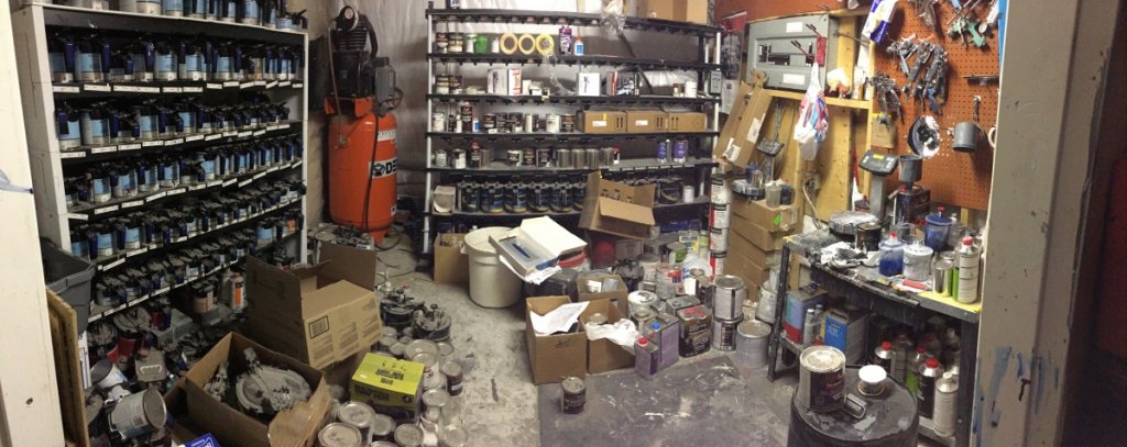

Percy's "paint room" is ridiculous! There must be 10's of thousands of dollars worth of House of Kolor materials and paint guns in here.
Starting the day with a bit more sanding, naturally.

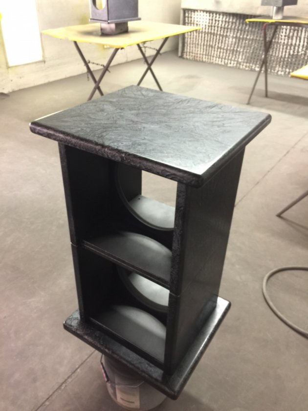

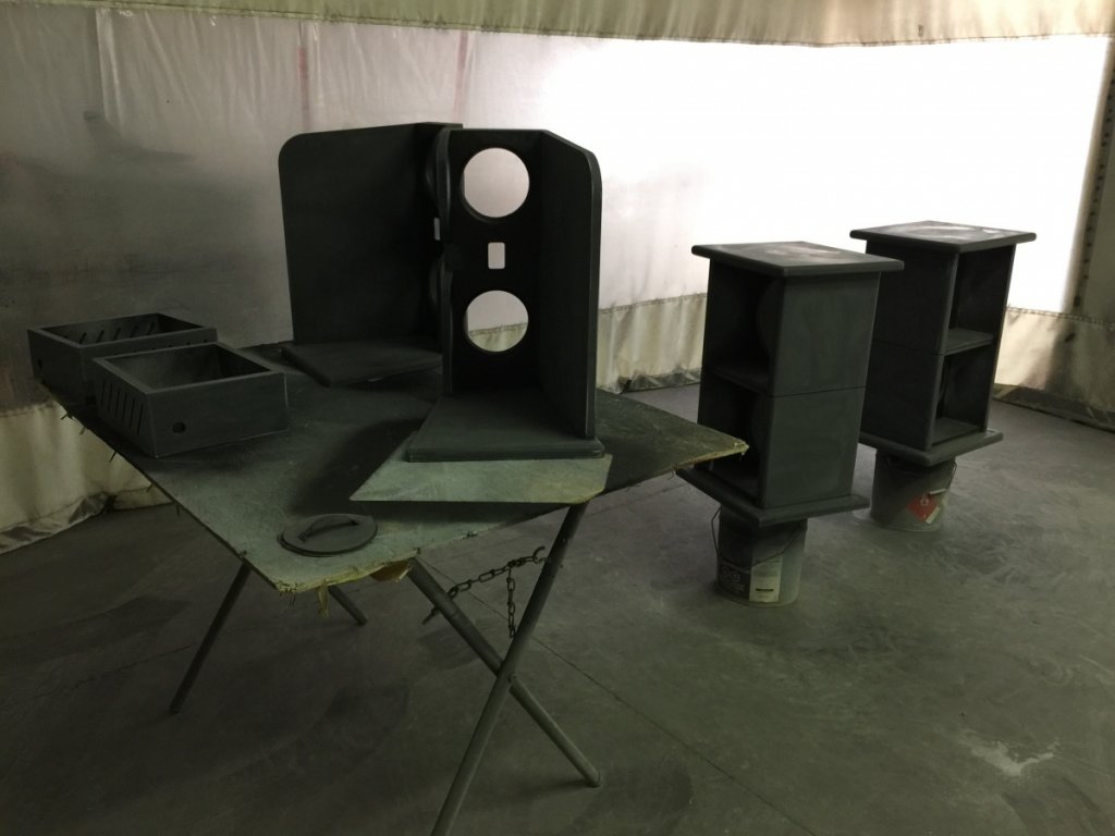

House of Kolor black primer on the duals - marblier on the other pieces
Marblized
Now time for some clear coat and polishing!
gaelen5
  • Posts: 31
Re: Ottica MTM and Dual Subs - Build
« Reply #15 on: 7 Sep 2017, 09:37 pm »

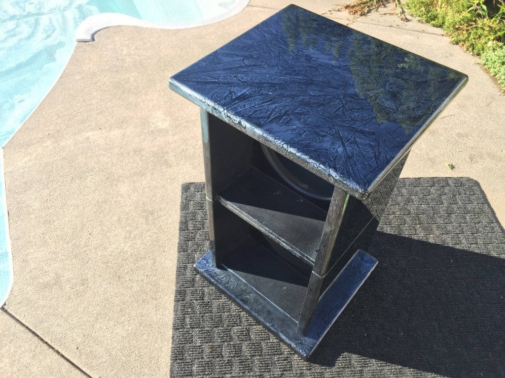

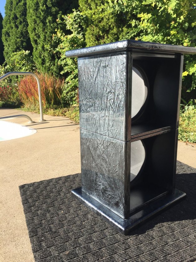

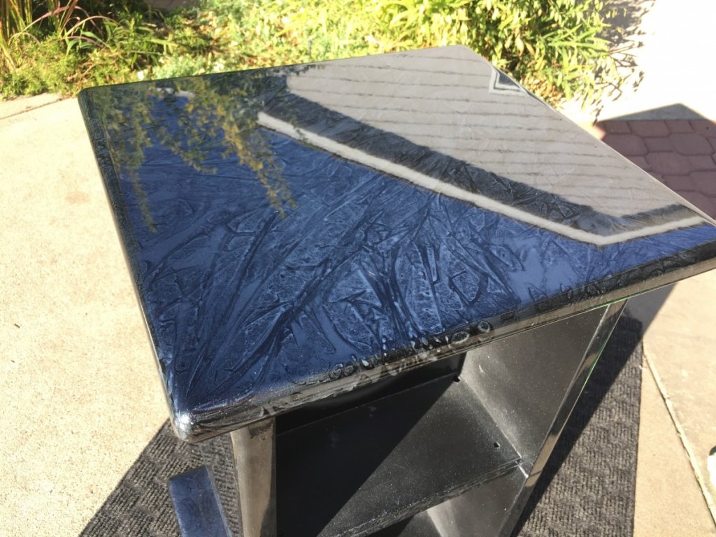

I had to pull the cabinets outside into the sun to do the paint justice
They turned out very glassy! I'm really impressed with the work Percy did. I was flattered that he let me be a part of the process.

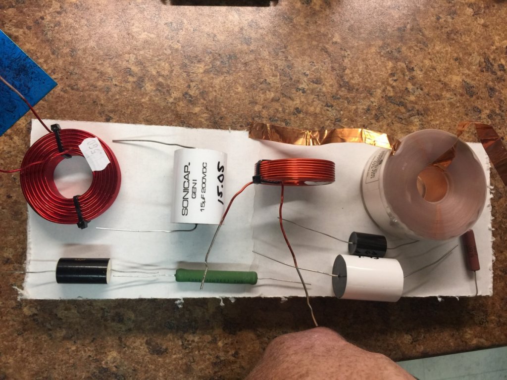

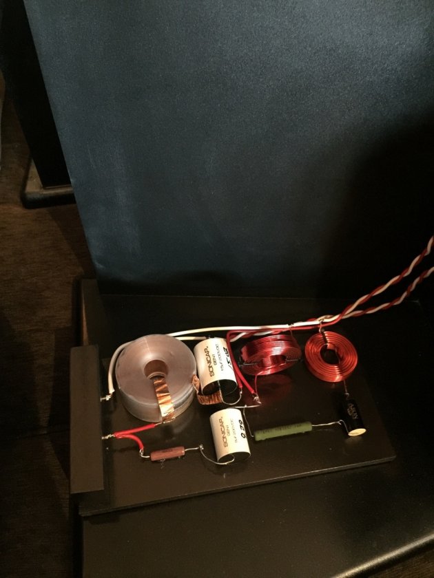

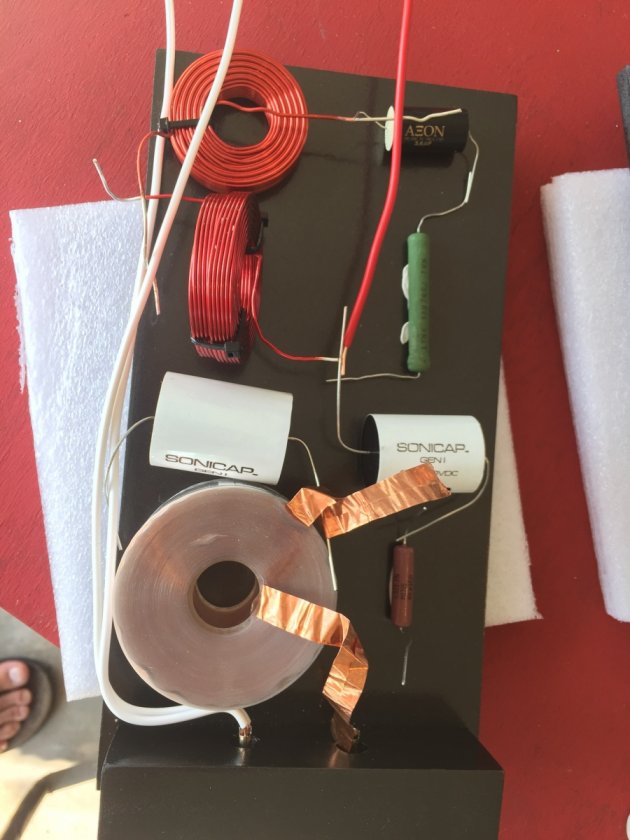

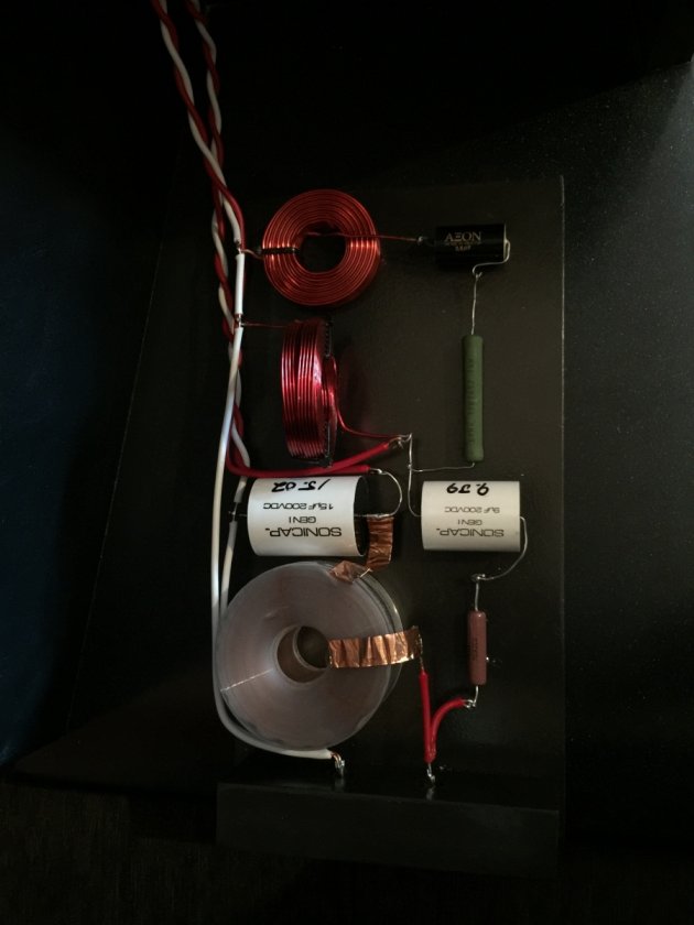

Here's my crossover. I didn't know anything about designing or orienting a crossover, but Captainhemo patiently held my hand through the process and explained it all to me. Now I feel smart.
Here we are discussing the layout on a piece of no rez
My layout I sent to Captainhemo before I soldered anything
Finished product. First one took me longer than I'll admit. The second one went together much more quickly!

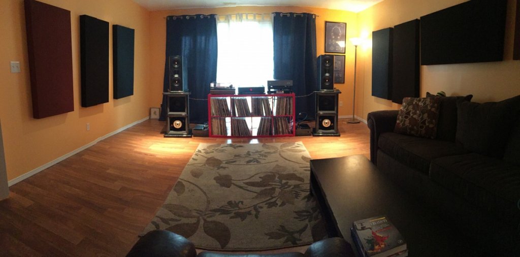

And here they are, at last, in my man cave.

That paint is gorgeous! Bet they look even better in person. Had any time to do any listening yet?  :bounce:

What do you think about the sound in your room?
