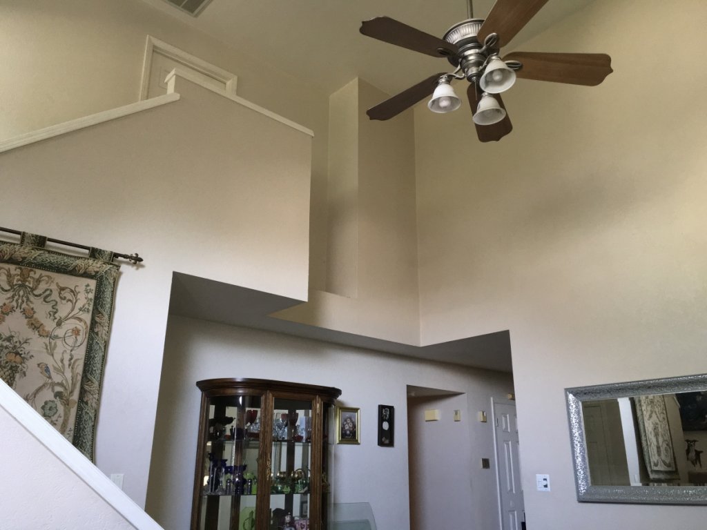

Delta77
Re: ROOM TREATMENT (NEXT) ?????
« Reply #6 on: 26 Aug 2017, 07:08 pm »
Thanks for your support so far,,,
I don't want to loose interest in this component,
I feel there will be an advantage to the system as a whole, IF done in a fairly correct manner..
        (Targeting Echoes from the parallel walls & high ceiling)
Here are a couple more before pics..
Front wall (high ceiling)..
Left (high ceiling)&(window to kitchen)
Right (half moon window)
Rear (just odd shaped)

Budget-- $800-$1200.. lets see..???..
brother love
« Reply #7 on: 26 Aug 2017, 07:35 pm »
Based on your budget, it is tough to beat GIK Acoustics Room Kit #3 for $856 + any extras you choose:
http://www.gikacoustics.com/product/gik-acoustics-room-kit-package-3/
GIK Acoustics recommended the #3 room kit for my 14' x 20' x 8' set-up & that is what I chose.
It seems that with your 17' height, that a cloud of ceiling panels would be a little less critical, but others with tall ceilings would be better to comment.
