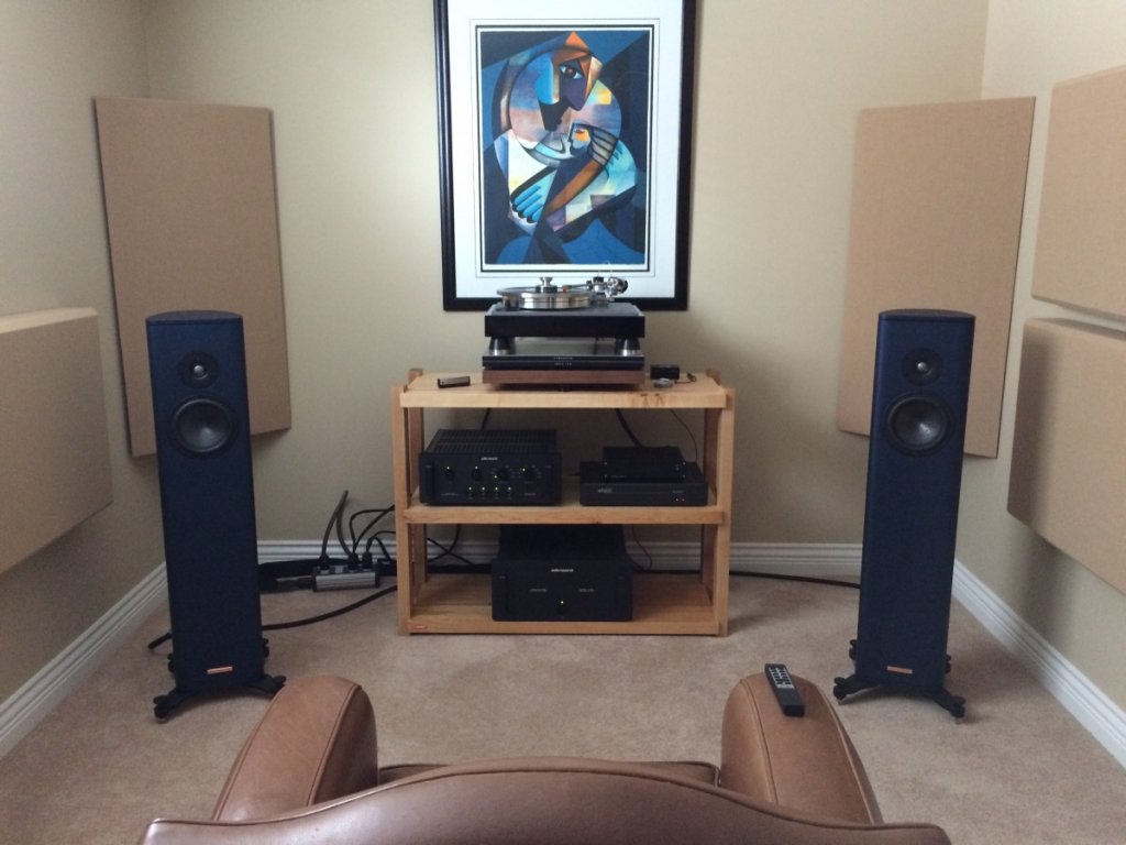

Help! My woofer rumble is more or less contained to the outside 3/4" of the record which implies a setup problem to me. Even the lead in groove can cause massive woofer movement.
The turntable was setup by the dealer in my house. This particular dealer is locally known for his setup expertise. One thing he didn't do was add additional anti-skate (I.e. the anti-skate is not hooked up). I have heard VPI tables can sometimes get away without additional anti-skate due to the force of the twisted wires running from the arm to the base, so maybe that's not the problem.
Setup: VPI Classic 3 with a Sumiko Pearwood Celebration MKII sitting on a Quadraspire rack.
The center of the woofer is 34" from the corner of the table, which is pretty much as far away as I can put them in my small-ish 10'x14' listening room. The speakers are a sealed design.
The room is well treated with adsorption and corner bass traps. I did mount the bass traps halfway up the wall as shown in the photo.
Any help would be appreciated!

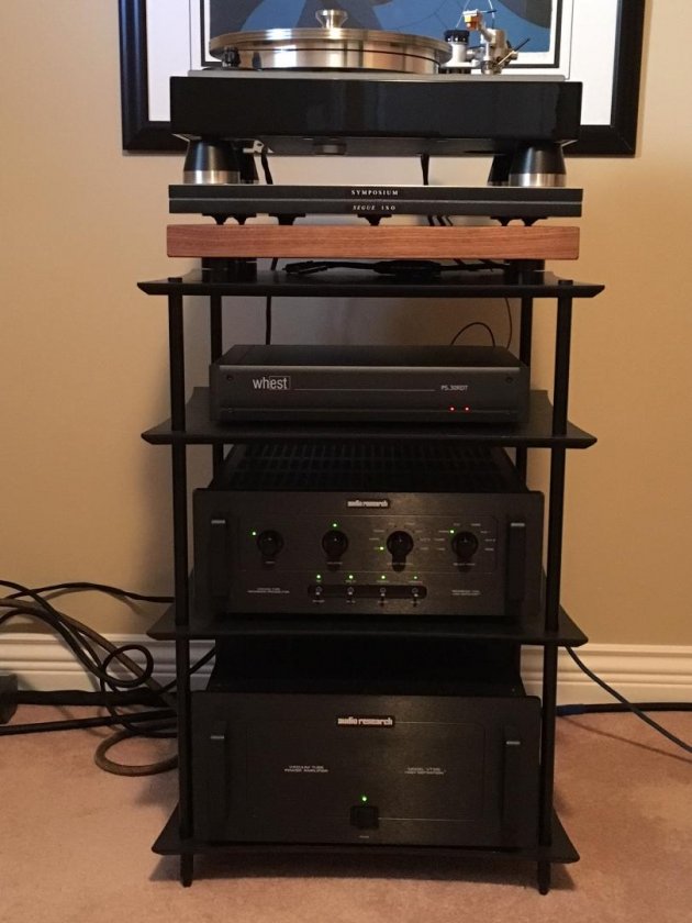

Final update(s):
1. I was able to pick up a used Massif Audio rack as suggested in an earlier post. It didn't help my woofer flapping but it is very stable and a worthwhile upgrade, particularly when picking one up used.
2. As a last resort, I commissioned a custom balanced high pass filter.  It's sitting on top of the Whest phono stage as pictured below. My woofer flapping problem is finally fixed with no perceived loss of sonic quality. I should have tried the filter earlier...
