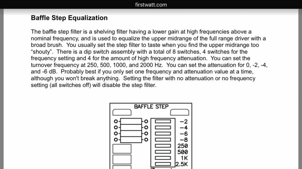

This was in my head
MJK
  • Posts: 472
    • Quarter Wavelength Loudspeaker Design
Re: Pure Audio Project Trio 15
« Reply #26 on: 23 Aug 2017, 12:34 am »
Those instructions are intended for a boxed speaker. The discussion does not apply to an OB where the rear wave is not captured in a box.

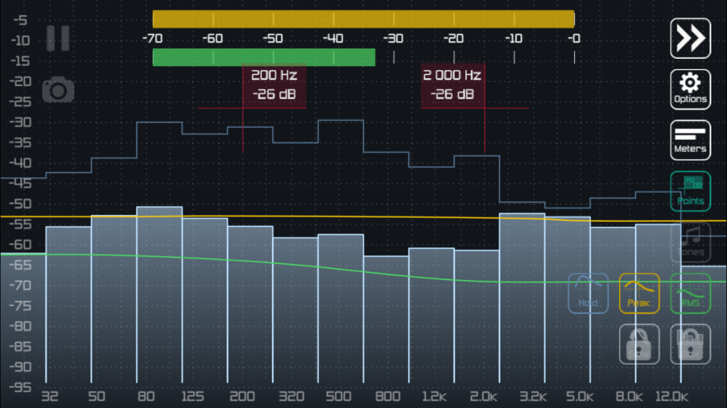

I did engage the shelving circuit to take care of the rise in the top end. I used 2500 and -4 db. We will see what comes if it.  Here is a extremely basic graph at 1 meter between bottom driver and fr.  I'll get a real mic tomorrow.

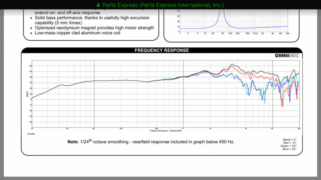

This is the spec graph
